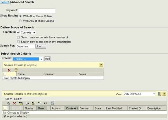

To Follow Don’s point:
When you perform the search make sure it’s an advanced search, not Basic. From there you have drop-down menus of the attributes you have available.
