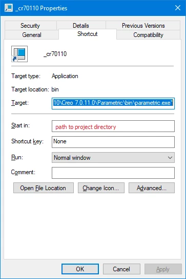

Sep 5, 2023 11:54 AM UTC
during start Creo is able to load up to 3 config.pro file.
Please read https://www.ptc.com/en/support/article/CS28227
In each project directory you can have Creo startup shortcut and config.pro specific for the project.
