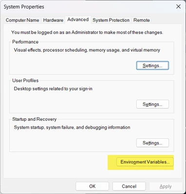

The environment variables are a Windows OS construct, not Creo Parametric.
Set environment variables in your system environment variables or within a startup script.
Use a dedicated batch file to launch Creo with all variables pre-set.
Keep your config.pro  file in a stable location and use PTC_CREO_ALT_SETTINGS_PATH to point to them—this helps when upgrading Creo versions.

pimm15-MoonstoneAuthor
Sep 9, 2025 5:49 PM UTC
Thank you!
I was able to replicate the independent config.pro re-location.  As for myself it saves the step of having to back out of the initial startup work directory so it will save time and help compact my settings folder for all of the pertinent templates held in it.

Sep 9, 2025 5:09 PM UTC
Using System Properties in Windows 11
