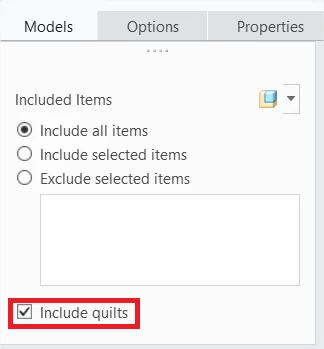

Hi everybody
Create a Section without the option "Include quilts" by default is annoying
so, a mapkey will help:
mapkey iq @MAPKEY_LABELinclude quilts;~ Command `ProCmdXsecPlanar` ;\
mapkey(continued) ~ Activate `main_dlg_cur` `chkbn.xsec_models_page.0` 1;\
mapkey(continued) ~ Activate `xsec_models_page.0.0` `PH.xsec_inc_qlt_btn` 1;\
mapkey(continued) ~ Activate `main_dlg_cur` `chkbn.xsec_placement_page.0` 1;\
mapkey(continued) ~ Trigger `xsec_placement_page.0.0` `PH.xsec_plane_coll_rep` `0`;\
mapkey(continued) ~ Trigger `xsec_placement_page.0.0` `PH.xsec_plane_coll_rep` ``;
