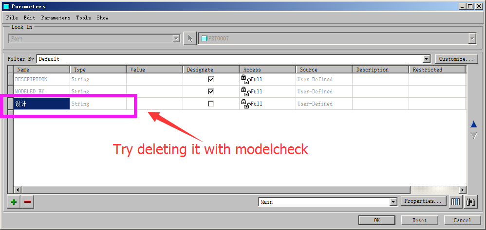

An interesting discovery about modelcheck
1.Create a new prt or asm
2.Create a new argument: “设计”,It means "design", but it must be Chinese
3.By using the modelcheck function, either delete or add renaming all modification operations will fail, that is to say, this parameter, only through manual modification, not through the modelcheck function to modify, we are interested can try.
4.Apply to all versions, including creo4.0M010
5.The attached version is wildfire 5
April 29, 2017
Yup, somebody posted similar finding recently.
Looks like ModelCheck ignores non-ascii characters. This applies to ModelCheck configuration files as well.
