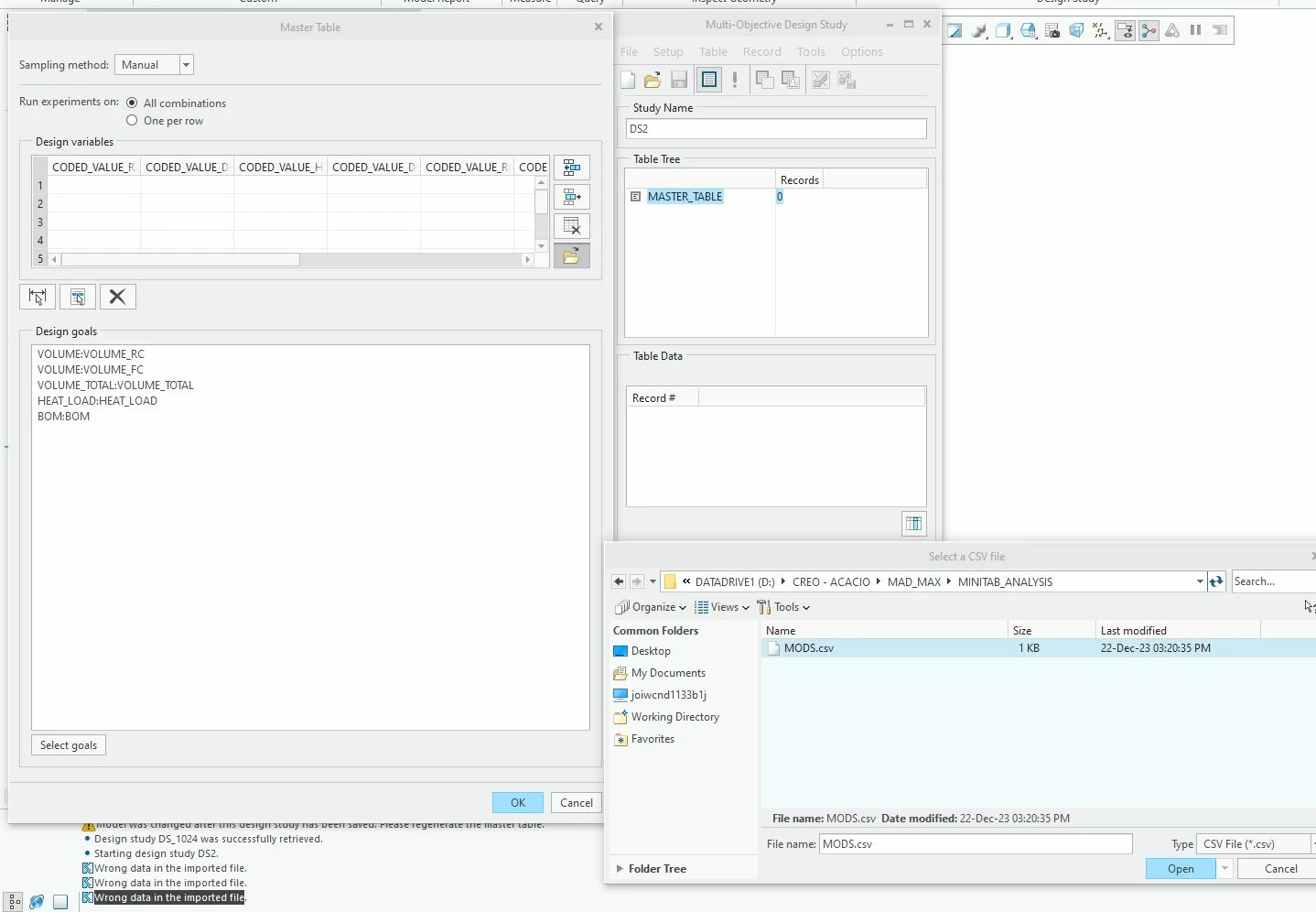

 I would like to know how to import the CSV data into MODS when I generate several combinations in other software, in this case it would be several points, but Creo comments that the imported data is wrong, would there be a correct way to import?

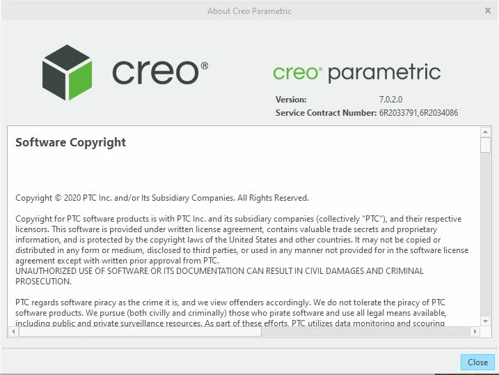

Can you share the CSV file you are trying to import? Keep in mind you will need to select "One per row" as the option from the radio button for "Run experiments on:" if you have the entire DOE already defined in your CSV file (as it is set to "All combinations" now based on your shared image). What version of Creo are you using?

Let me share the file to try import and my version of the Creo is 7.0.2.0

Ah - this is an easy fix! You must have your CSV file contain only the numeric values. This means you need to select the model dimensions and/or parameters first to populate the top row of the "Design variables" table before you import the data. This forces your CSV data file to be organized to not only align with the column dimension/parameter names you just selected, but also match the type of experiments you wish to run - "All combinations" or "One per row". This will get you going without further issue.
