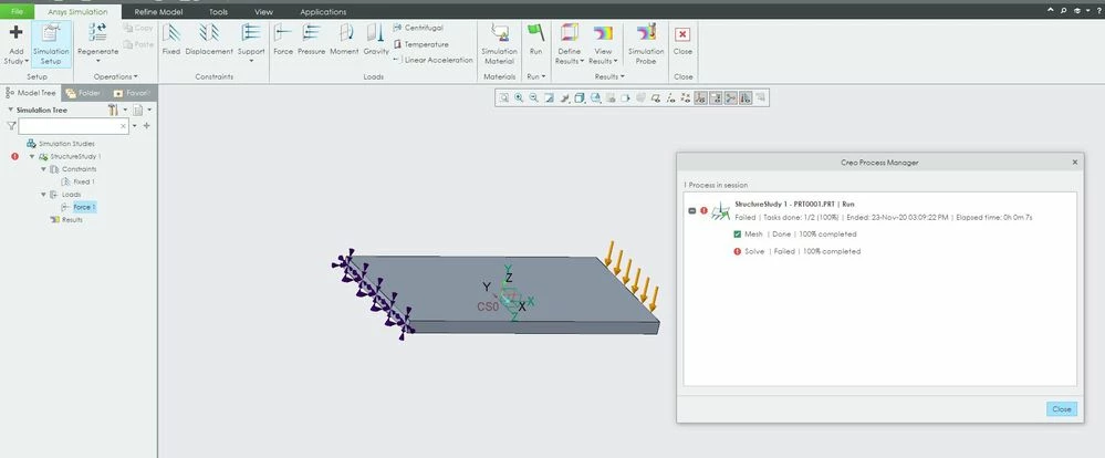

Analysis Returns Error
  • November 23, 2020
  • 1869 views
each analysis returns this error to me, how can I solve it?
doing it in simulated, can do it without problems
February 13, 2023
https://www.ptc.com/en/support/article/CS349290?source=search
To resolve this
  • Customers have had recent success updating to the latest Intel HD Graphics drivers
    • If the latest Intel HD Graphics driver did not resolve the issue, please try again a successfully working driver, e.g. 27.20.100.8681
  • If updating to the above Intel HD Graphics driver did not resolve the issue, clean out the installed INTEL drivers completely and reinstall them directly from INTEL’s website.
  • If the above items did not resolve the issue, some customers have had success disabling integrated Intel graphics in the BIOS
