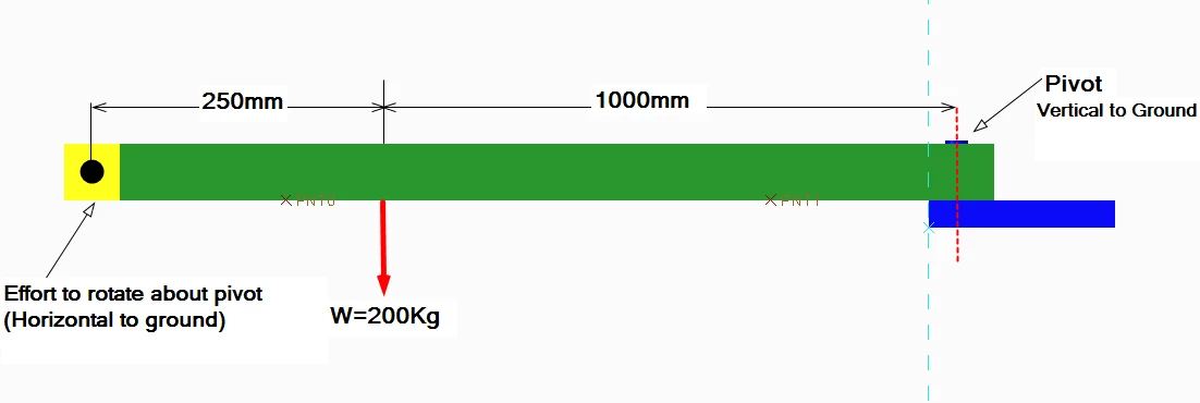

I have case where I need to calculate effort required to rotate platform about vertical pivot. Platform has its own weight around 200Kg and weight itself resistance to move. I am new to the Creo mechanism and knew little things about this application. Anyone can help me to understand approach that I should  use to get required result (similar to hand calculation) and want to know main steps describing dynamic entities that need to add.
(See attached image)
