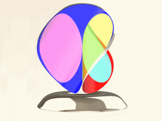

(Click the image to see the animation)

  • My Servo Motor Definition>Profile is set up so that the full animation ranges from 0 degrees to 360 degrees. Important: This means that the first and the last image are exactly the same. The file format created by the Capture routing is <filename>_00nn.BMP starting with ..._0000. Remember to omit the first image of the sequence when creating the animated GIF! Therefore, my animated GIF was created with ..._0001.BMP to ..._0075.BMP
  • With PhotoScape open, click on the AniGIF tab and you can now drag and drop all the images onto the graphics screen. Use Shift to select the full group of images.
  • Now you can set the timeframe to apply to each GIF frame... I used .02 as noted before. PhotoScape also gives you a scaling option (NICE!). My original BMP files were 640x480 and I scaled it to 50% (320x240). The overall file size was excellent... my BMP's were 901kb each, and the finished GIF (above) is only 832kb. I am very pleased with this result!

Yep, even a constant motion loop is working seamlessly.
Click on the image:
One bug I uncovered... setting the time to .01 is not correct but .02 works.
