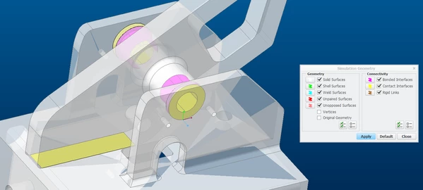

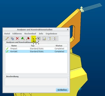

I have a model that I'm trying to run an analysis on but I can not get it to mesh properly. It is a very odd situation because I can mesh it no problem in AutoGEM and view the mesh results with no errors or warnings but when I start the Analysis and it attempts to mesh the model, I get a completely different number of elements in the mesh and errors. I have tried deleting all the existing mesh files, deleted the folders for the Analysis and even copied everything to a new folder and I get the same results....AutoGEM makes 125k elements, Analysis and Design studies makes 105k elements with all of the default options.
Anyone have a clue what could be going on here?

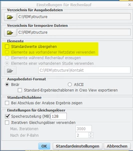

I have tried every combination of the "Elements" options including overriding defaults and disabling it altogether. It makes no difference in the results. However, I have noticed this message whenever I try to run the analysis:
Copying elements from an existing mesh file ...
Element copy failed.  Creo Simulate will automatically remesh.
