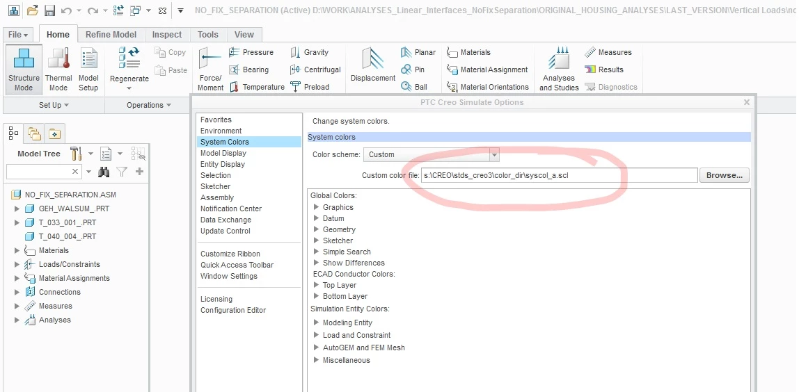

Hi People!
I don't know why, but suddenly the cool background color (blue degraded) from Simulate dissapear.
Can anyone send me the file? I don´t find where it is. Looking in that directory (file attached) I don't find it.
Thanks!!
Best answer by mbonka
Hello David Rodriguez Ortiz
desired configuration option is:
system_colors_file E:\Applic\syscol.scl
My syscol.scl is attached (something like WF5 appearance).
Hope it helps...
mbonka2-ExplorerAnswer
2-Explorer
August 30, 2016
Hope it helps...
August 30, 2016
Thanks Milan!!
