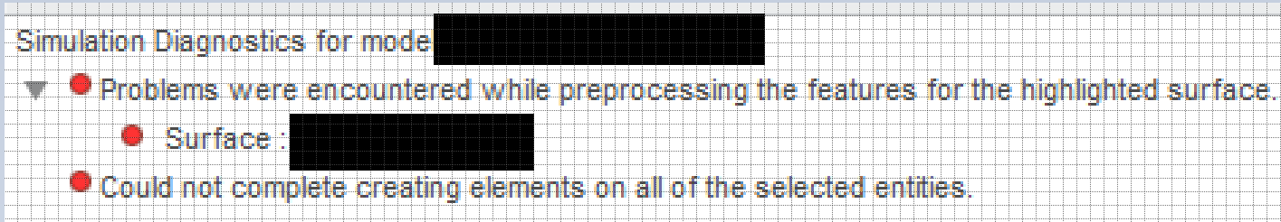

Hello!
Sometime This happened to someone?
It's no clear about the problem of the 3D element..

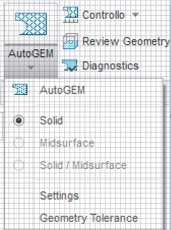

    Hello Federico,
    This error can be occurred, sometimes if Shell Geometry is used
    You could try following steps to solve this error:
    • Set AutoGEM Type to Midsurface
    • Check Ignore unpaired surfaces option in AutoGEM setting
    • Try to create mesh again

    Hello!
    thank you but the command is unable
