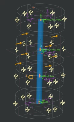

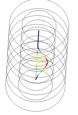

Hello, I've been trying to simulate one interesting case in which i did stuck.

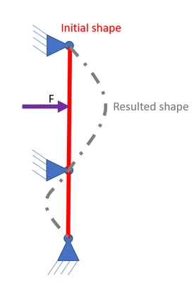

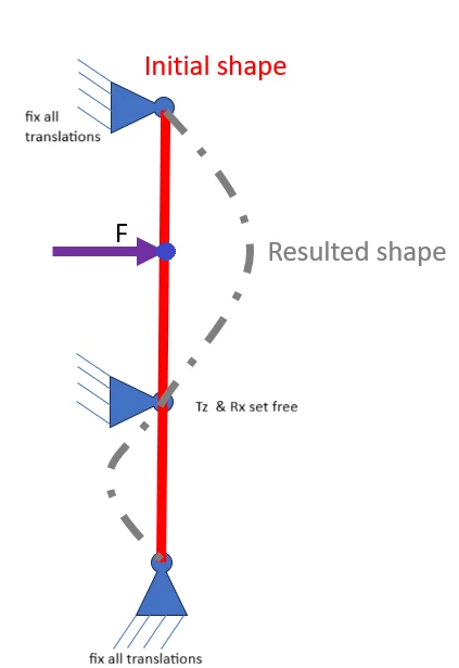

Here is an image of what i've been trying to achieve

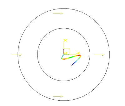

Here is an example of using advanced rigid link beam is discontinued after first rigid link is applied

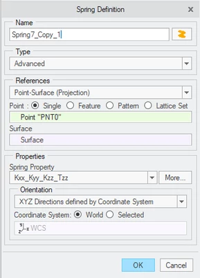

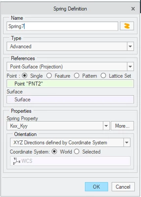

Here is an example of using advanced spring (point to suface(projection)). It is deforming in wrong direction
Can you help me solve this mystery?

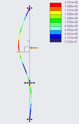

The mystery is that nodes on solid elements only have 3 dof and links to them will receive this limitation from them. This means that the selection of rotational dof on the advanced rigid link have no effect. It is also quite easy to create dof conflicts and unconstrained conditions when using links.
Add an intermediate rigid link between your original links and the beam that is point to point and the rotational dof are now in effect and can be free. Chaining links like this is not unusual in FEM.
Looks like all models hasn't been uploaded so here it is again
8-Gravel

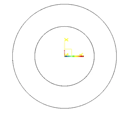

Do you mean like this?
These is my boundary conditions and I only use sketches, points and no solid model
yes,exactly how you've shown it.
but i have to attach beam to solid geometry by some kind of a link
