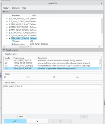

I've been interested in the same capability for about 20 years now...and have been asking for it all these years as well. There is an output parameter from a "Motion Analysis" in Behavioral Modeling whose name seems to suggest the entire set of data for the MDX/MDO output measure will be returned. Its BMX parameter name begins with "SERIE_" followed by the MDX/MDO output measure name. Its description states "All values of parameter attained during motion". When I test this out, I find no data anywhere in any directory my colleagues and I imagined it might be. A simple query of this BMX Motion Analysis feature from the model tree for "Feature Information", simply lists this output's "Current value" as a "series", compared to the typical individual numeric values returned for the other output options (max or min, or time at max/min, etc.).
I've placed a question about this topic with our PTC technical expert. I will share any useful feedback here.
Oct 19, 2023 8:12 PM UTC
Minor Update:
I happen to have found where the array of data is stored - through a very strange accident! When you select to capture the "SERIE_XXXXXXX" motion measure - as seen here in my example while creating/editing the "Motion Analysis" feature:

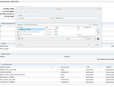

it does get saved inside the assembly model itself as a parameter that is only seen from within the "Parameter" dialog box. Here is a sample of the Parameter dialog showing the 3 different measures I asked for, on top of the feature's "Feature info: ANALYSIS" page:

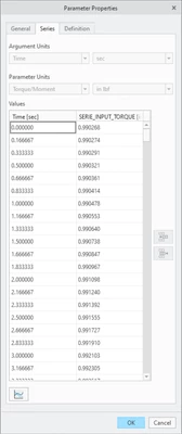

Notice how the words "Series" are italicized in blue - this is a link to open a dialog that contains the entire array of output from MDO. You can then click the word "Series" and get a box that looks like this:
The only way to export this for further use is to click the lower left icon to view the plot, and then export the plot data to Excel or a text file. I have not found out how to recover each one of these data arrays if you run a MODS or a Sensitivity study, since each run would generate a unique data array...or if they are even stored for each individual run.
