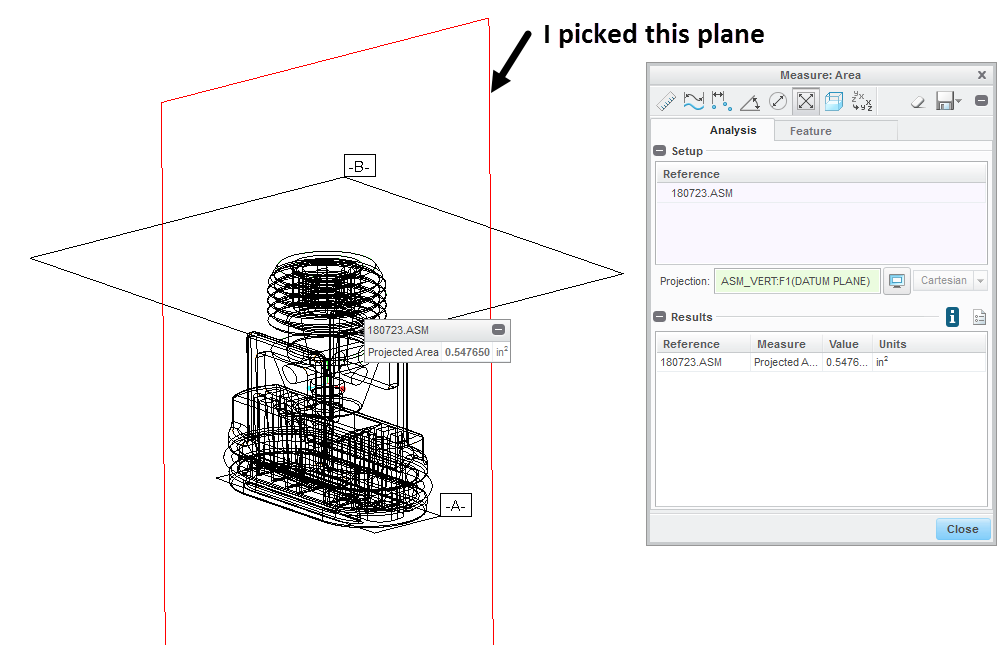

Am I correct to assume you used the Analysis, Measure, Area, Projected Area option?  I'm getting a value by using that option:
1) Open up the Analysis, Measure: Area dialog box
2) For your reference go to the top of the model tree and select the ASM file (or if it's a sub-assembly in a larger assembly pick that file)
3) an Error will appear until you select a plane for the Projection direction.  Once I did that the Projected Area measurement value showed up in the Results area
Be careful not to pick the icon next to your Projection direction selection - that changes your selection to the View Plane (can be deselected to return to your specified plane).  Here's a picture of how it looked for me

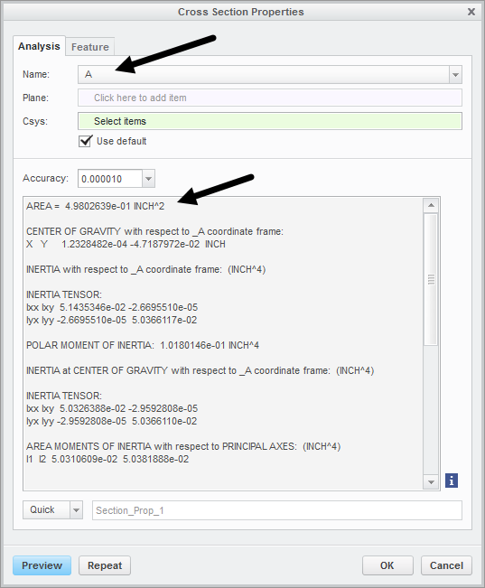

Another possibility - create a x-section using the plane you want to be normal to.  Then go to Analysis, Mass Properties, X-Section Mass Properties.  In the dialog box pick the name of your X-section and the results will include the Area of that X-Section (see below)
