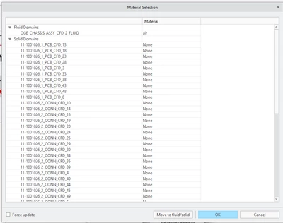

Hi – I hopefully have a quick Creo analysis Flow question.  I have an assembly and in Flow it’s not letting me change the material properties of the solid domains.
I go to each component and select the material from the pulldown menu and hit OK.  I then click on materials to see if my change took and it still displays "none" for material
In an older simpler model I was able to change materials, now I can’t .  How can I fix this?  I tick the "force update" box and that doesn’t help

You have to apply those material properties in the part file of the solid domain. File/Prepare/Model Properties... You'll get a popup window where you can edit the material.
