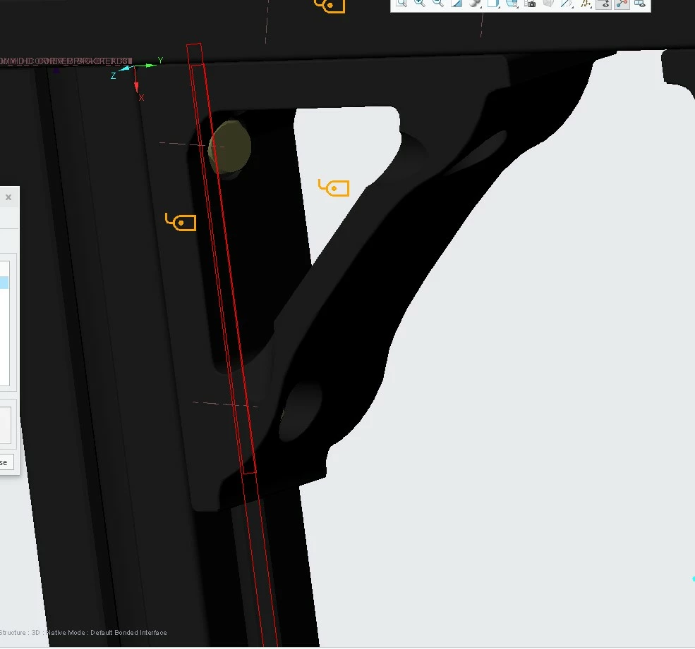

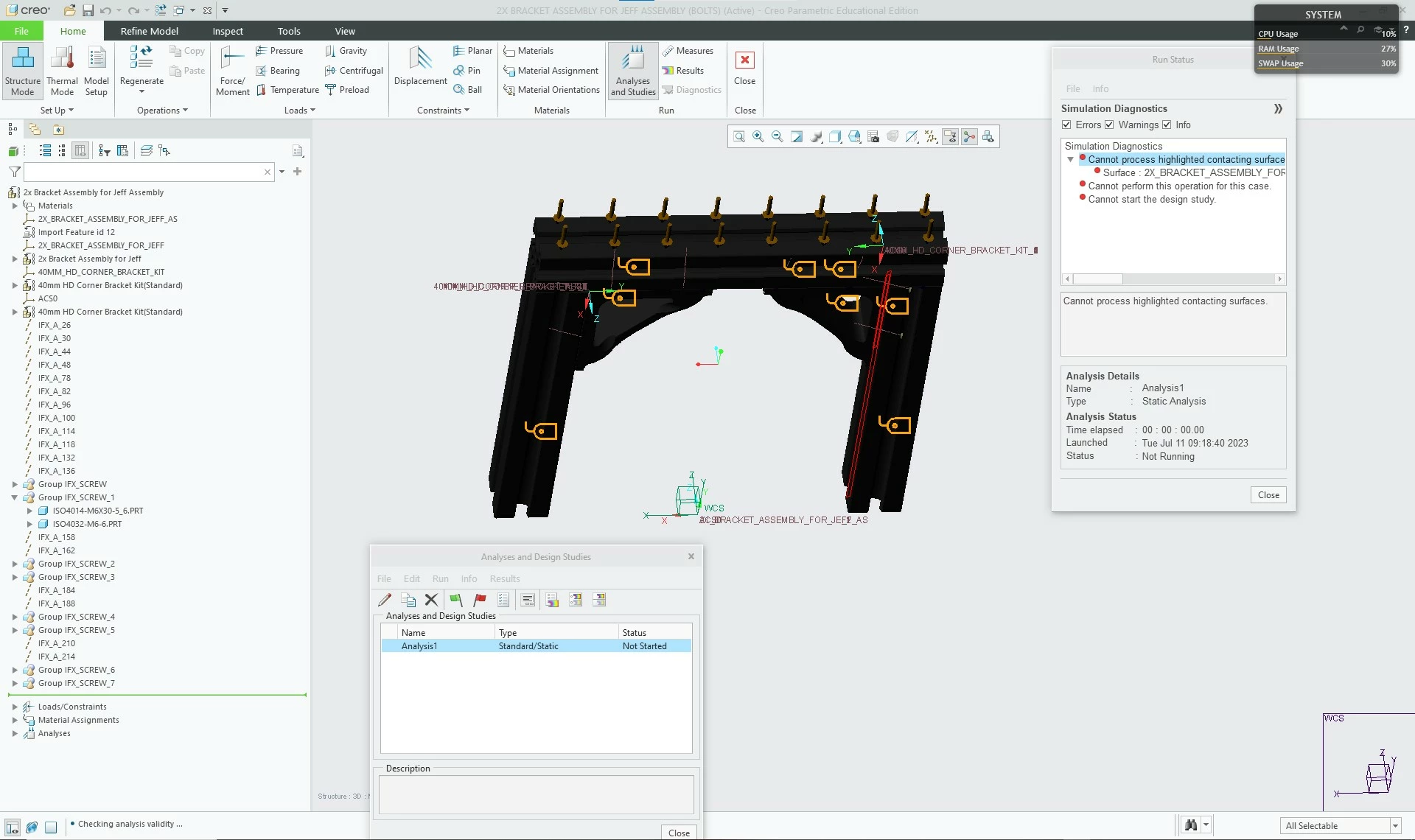

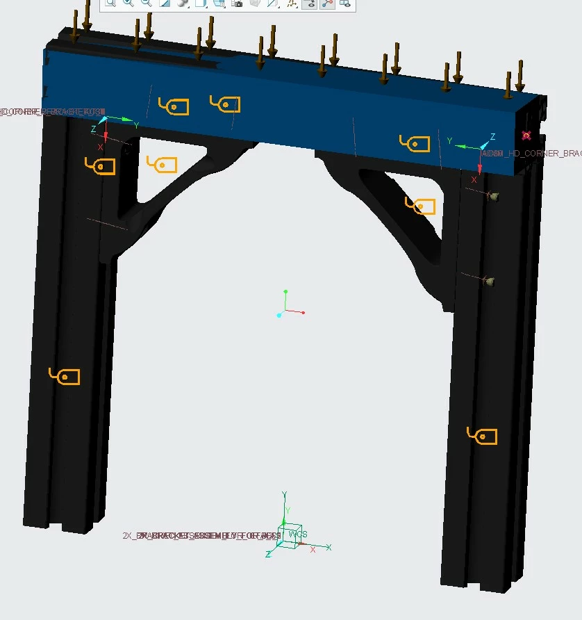

I’m trying to run an FEA on a fixed support beam, I replaced all the bolts with “intelligent fasteners”. I keep getting the “cannot process highlighted contacting surface” error

Articles:
Discussion - "Contact surface area error": https://community.ptc.com/t5/3D-Part-Assembly-Design/Contact-surface-area-error/m-p/326502
Jul 12, 2023 12:25 PM UTC
Thanks so much for replying!
I had already seen the first two posts.
I will try the Refine Model > Beam option, and see what results from it.
Thanks again for replying.
Jul 12, 2023 12:36 PM UTC
I created the beam (I think correctly), but it didn't seem to help.
Any additional assistance would be appreciated.

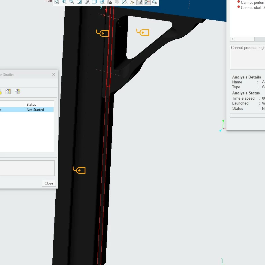

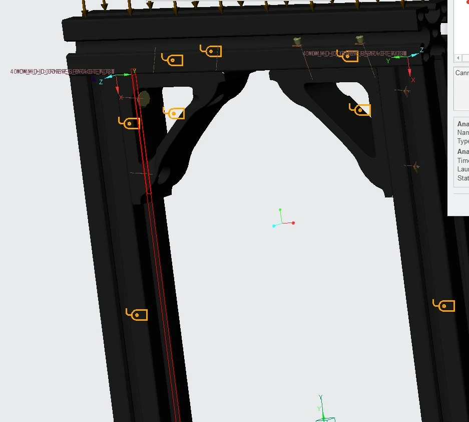

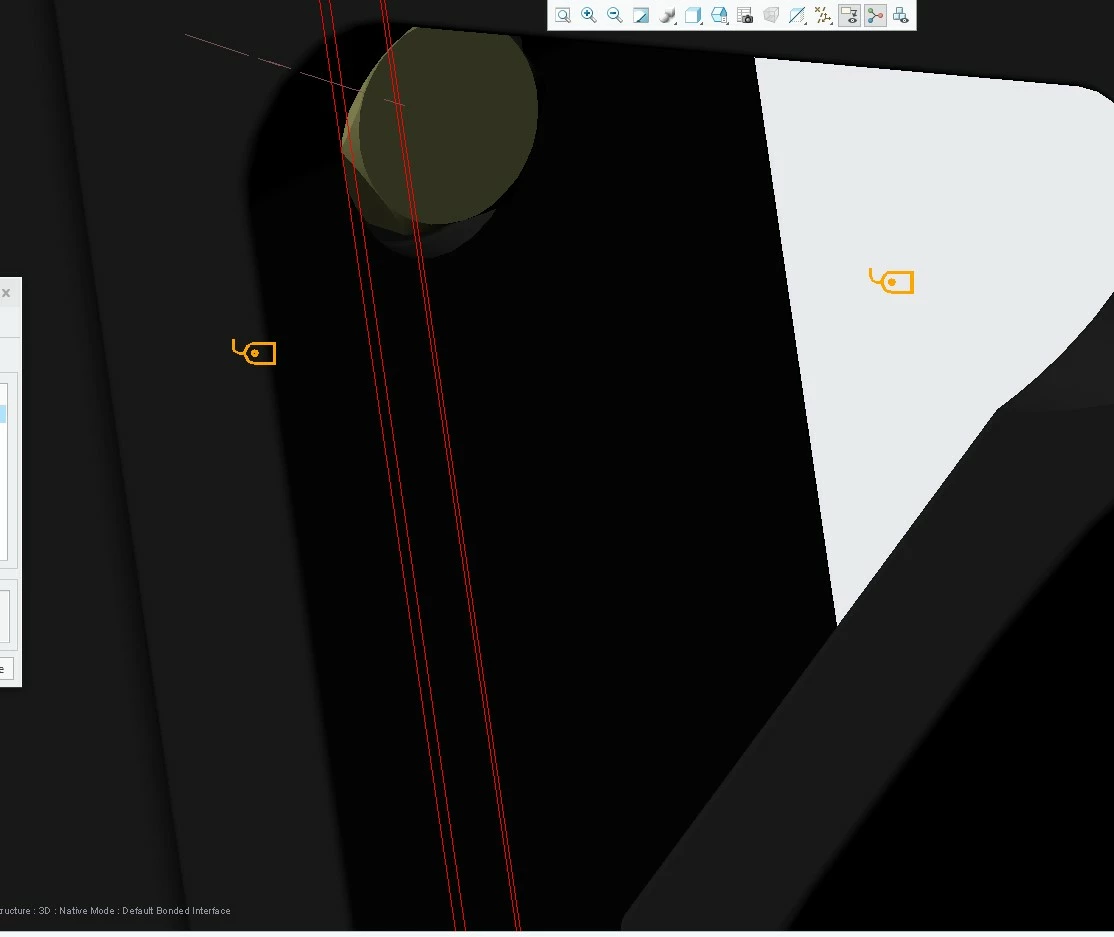

can you make better screenshots?
Jul 12, 2023 12:20 PM UTC
Certainly, I can post better screenshots. Please let me know if you would like more/better still screenshots.
Jul 13, 2023 8:48 AM UTC
Sorry, man, but you have black model with black edges. There is still 0 visibility on the problematic region. try changin model color to white/light gray. take a screenshot without first part than without the other. Describe problematic region in text and include simulation features applied to them. What kind of interface you are using. Most of the time those are tangential surfaces. But can't prove it from those screenshots.
