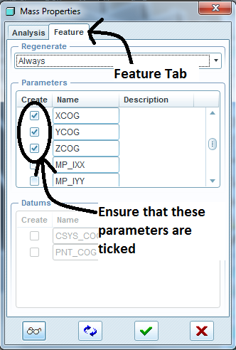

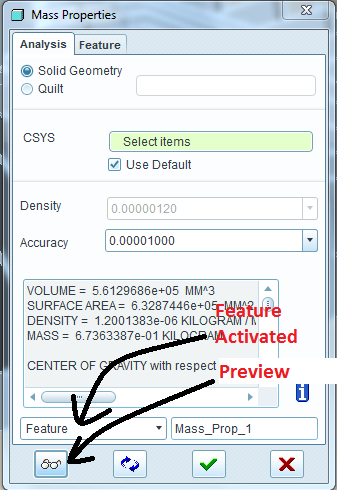

Analysis --> mass properties
Click on the Preview button.
Ensure that the Feature Option is selected at the bottom.
The following pictures should explain.
Having done this, you may choose to have a POINT at this COG which would update dynamically at every REGEN.

a)You can use system parameter pro_mp_mass to make your user parameter and use it in drawing, or family table
b)You can make a feature parameter in mass properties just like xcog,ycog ang zcog stated above; and then use this feature parameter to make your user parameter and use it in drawing, or family table
2.COG
You can use the feature parameters xcog,ycog ang zcog to make your user parameterand use it in drawing, or family table
