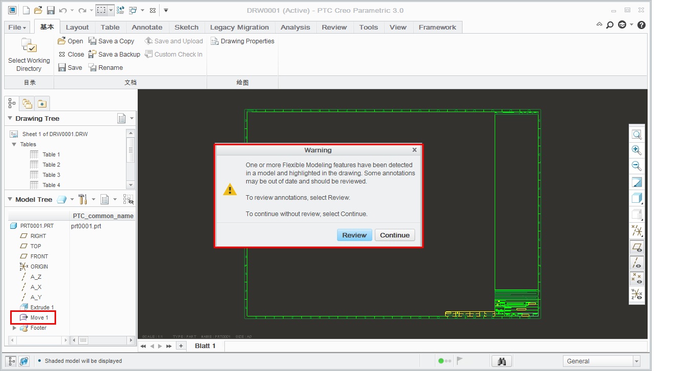

   i created a model and use the flexbile move command,and then i finished my job and created a drawing,but as the picture shows
the creo pop a dialog and show some warning,can i make some config and shutdown the dialog?

Yes, there is a documented option for this:
File->options->configuration editor->Find->type in "warn"->Find Now->
in the list you should see the option drawing_warn_if_flex_feature; set this to no (default is yes).

Thank you very much
