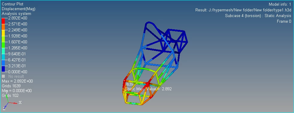

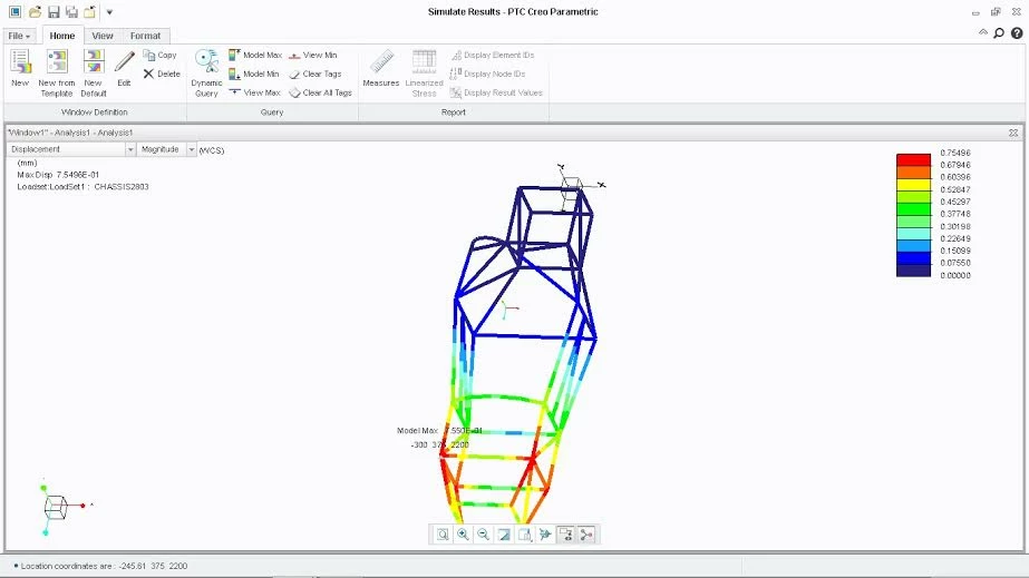

I have tried to do a chassis analysis in Creo Simulate using beam idealization and same in hypermesh but when I am comparing the results both show different value for the same loading scenario.can any one suggest why this of problem exist.

CREO SETUP
I modelled the chassis wireframe and used beam idealization for assigning material and geometry of pipe to the wireframe in Creo and constrained all the four rear suspension pickup points in all 6DOF's.Then I applied vertically upwards force on Front right suspension points and downward force on front left suspension points and then I ran the analysis.
Same I did in hypermesh using same material properties .
If you have hyperworks 12.0 and creo 3.0 i can send you the files and you can look into it.

Okay, so I can't read your Creo3 file since i'm still on Creo2 (unless someone can tell me how?) but I built the model from the igs file you gave me, using dimensions from the Hypermesh file.
My results:
HM12: max displ 1.157 mm
Creo2: max displ 1.175 mm
This is different than both of your results.
Some pitfalls that I can come up with:
* make sure to also constrain rotational degrees of freedom in Creo (default is only constrain displacements)
* make sure to check wheter your tube dimensions are correct (use radius, not diameter), I used outer radius 12.5 mm and inner radius 10.5mm because that is what was in the HM model.
* in HM make sure to turn on error checking; for some reason CBEAM 3050 and 3049 had a direction vector of 0,0,0 that i had to fix manually in the fem file before the model would run.
* check beam orientations; Creo2 for some reason still insists that you specify the orientation for a rotation symmetric beam profile, and does not use sane defaults when you select multiple lines
* watch out when applying forces; if you apply 100N on 2 points in Creo, it may be that Creo turns that into 50N per point (i'm not sure about this, I alway avoid this by modelling separate loads for each point)
* check units in Creo, use mmNs if possible
