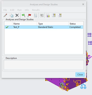

I am using Creo Parametric - Release 6.0 (connected) Release 6.0 and Datecode6.0.3.0
Analyses and Design Studies window does not display saved analyses. I can open the results but cannot edit the analyses. How can I fix this?

    Me too have the same issues in CREO 6.0.5.0.
    Go to the folder in Window Explode, find the name of your analysis, copy the name, come back to the Simulate window and paste the name to a new study, it then can revivify the disappeared analysis results.
