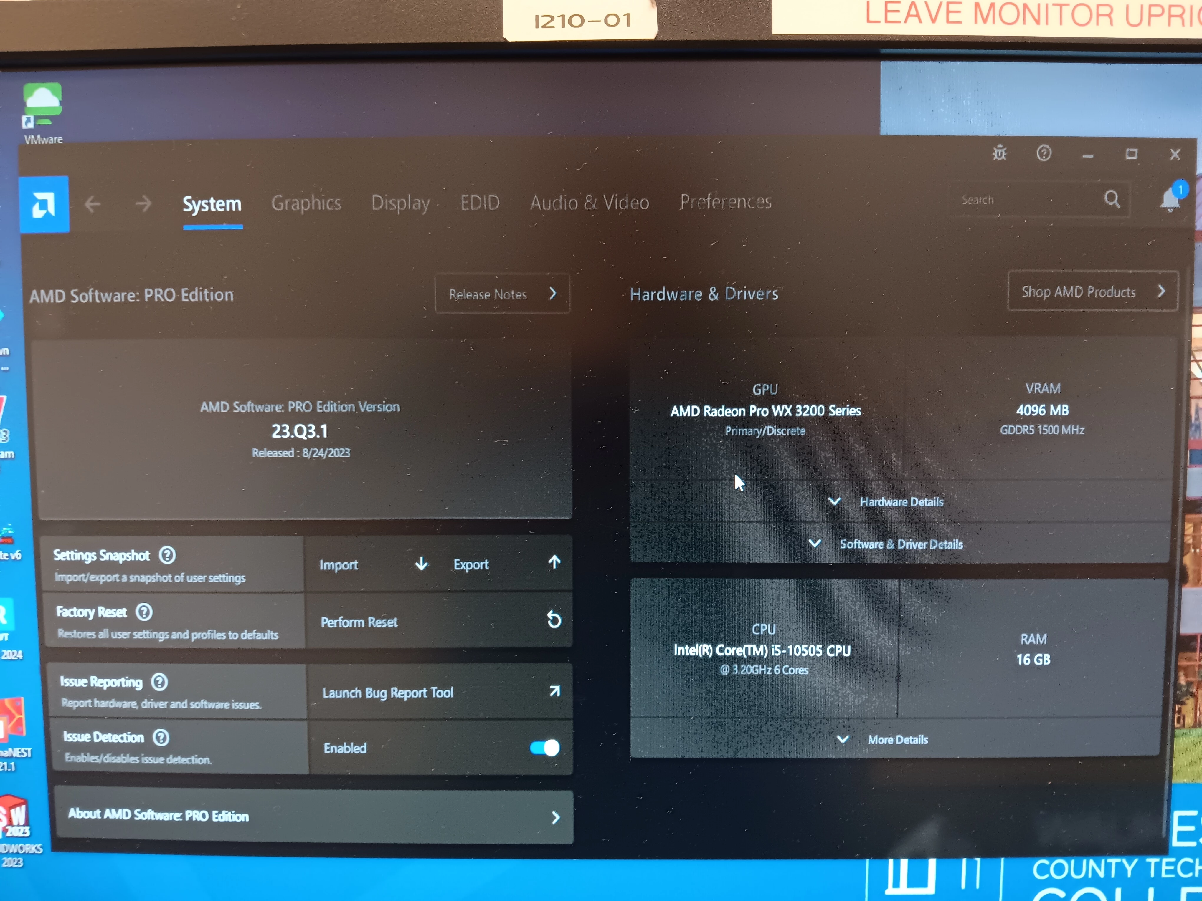

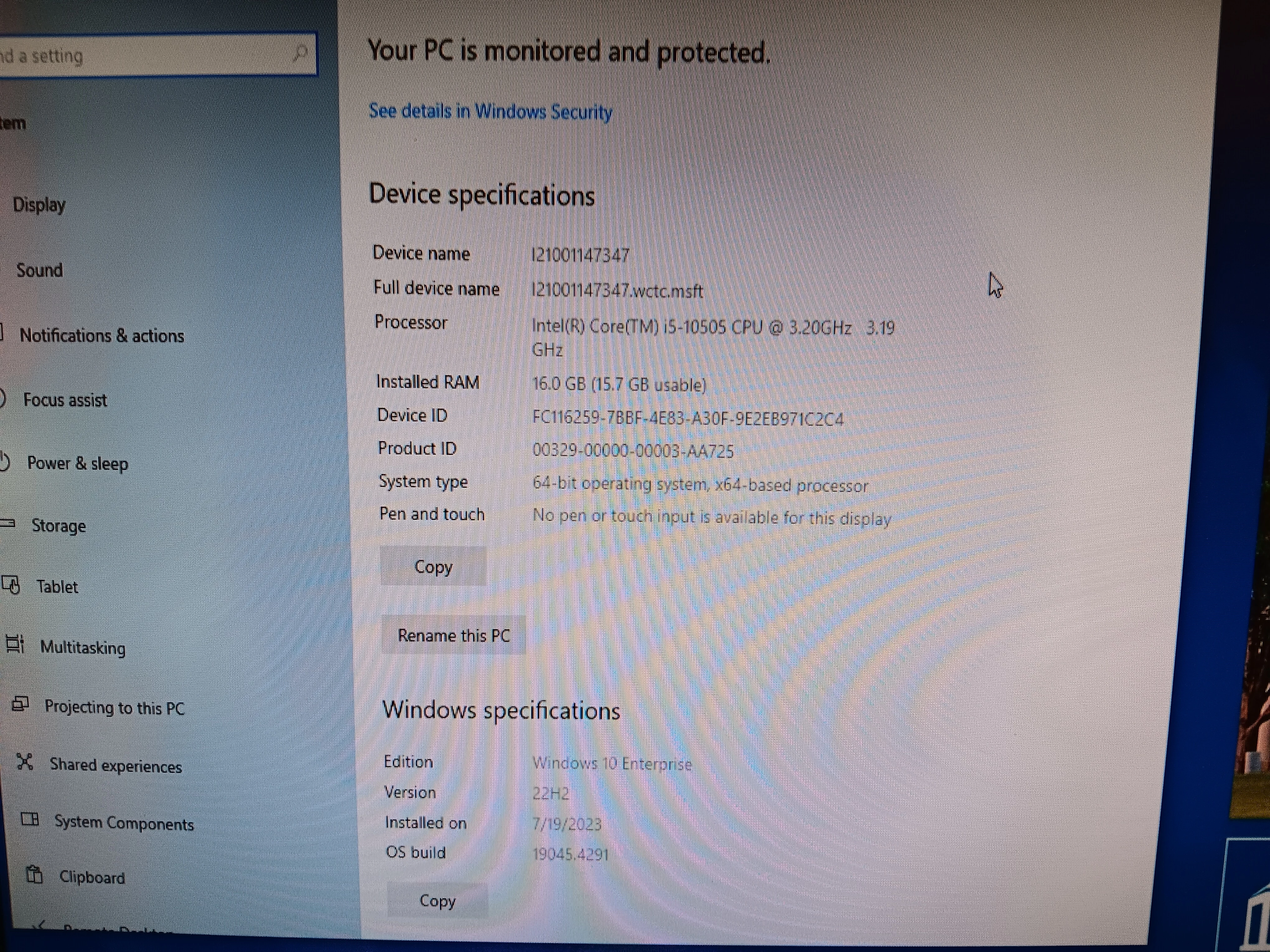

We are doing trivially simple analyses in Creo 9.0 Simulate (Not Simulate Live...) and we are consistently crashing the computers.  (Problems taken from or similar to exercises in an SDC textbook.)  See the attached for the specifications on these computers.  I have some students that know a lot about using FEA and they are not having any more success with the classroom computers.
What might I (the instructor) try, to stop these crashes?  Do we need to upgrade our computers?  I suspect this is true.  However, are there things we could change/try on these computers that would help?  (See the attached pictures, which I believe have sufficient information for people to comment.)
https://prodart.pl/wp-content/uploads/2022/05/creo9_hardware_notes.pdf This link seems to say that Dell computers with AMD graphics are NOT approved?  And it appears that these computers have AMD GPUs and are Dell computers.

My experience is that if it is not on the approved/supported hardware list from PTC you are going to run into graphics driver issues. I had a similar problem when my company switched to Creo 7.0. Opening a symbol or moving a drawing view would cause a fatal error. It was not resolved until I upgraded to a supported video driver.

You are quite right.  Turns out our classroom computers have AMD GPUs.  As soon as we changed rooms for computers that have Nvidia GPUs...problem solved!

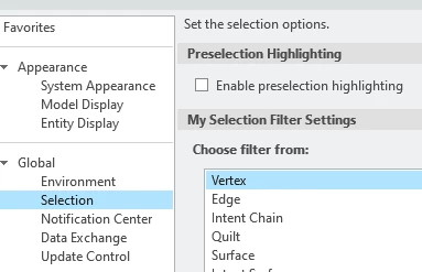

1. Turn off preselection highlighting.
2.  Add these to your configuration file.  If it solves the crashes, maybe some can be turned on for better experience. (You can also get to most of these in the configuration menu).
