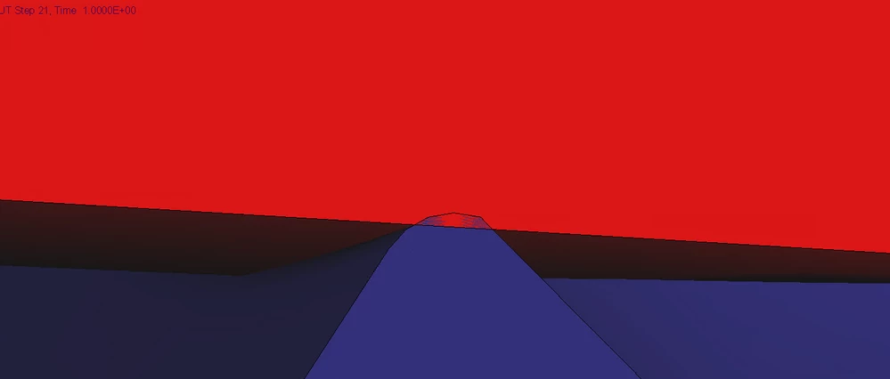

I am using Creo Parametric - Release 6.0 (connected) Release 6.0 and Datecode6.0.3.0

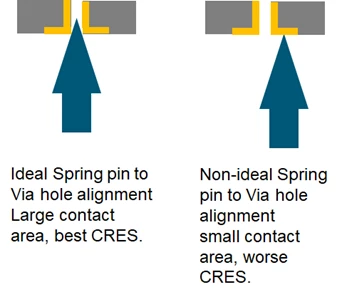

I am working on a spring pin connection to a pcb device. There are two cases in question an both applies this problem the first is when perfect alignment to the via hole occurs. For this case deformation should occur on the edges that the pin contacts the pc yet instead of that overlapping between both assemblies occurs. On the other case the alignment is not with the via but instead only on the plating (similar to an indentation process ) but the pin tip also instead of penetrating and deforming the surfaces the results show overlapping once again

So i am studying the following situations
The goal is to obtain the contact area and contact force when the docking process occurs and also have a understanding where the contact occurs on the via.

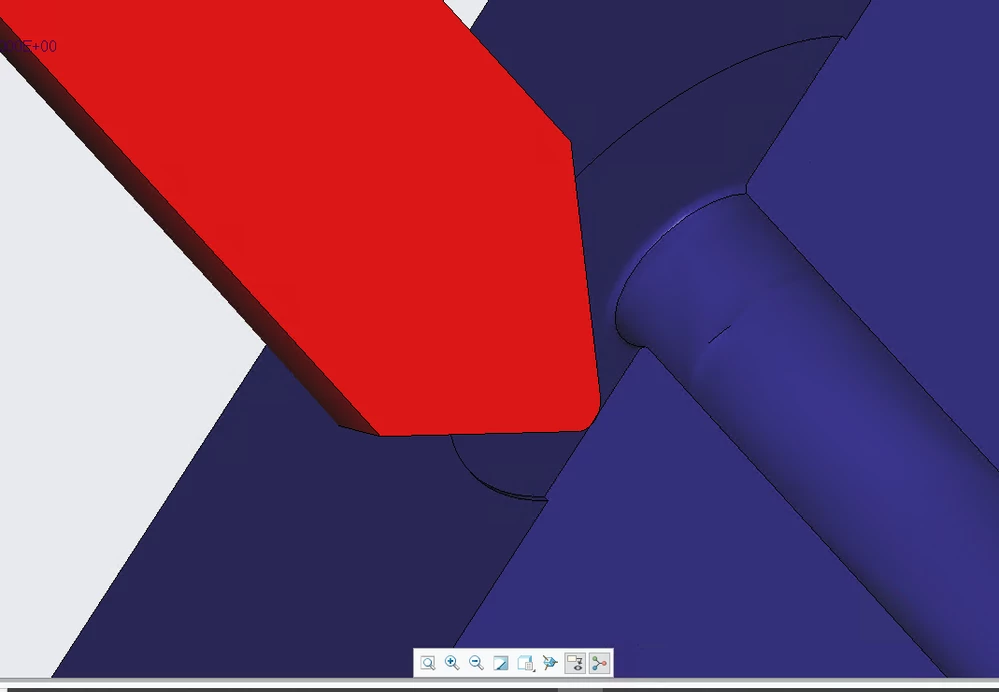

I am using a static analysis and applied a force on top of the pogo and fixated the board. I also used a symmetry constrain to speed up the problem
For the materials i used elastic-platic regime for each layer the

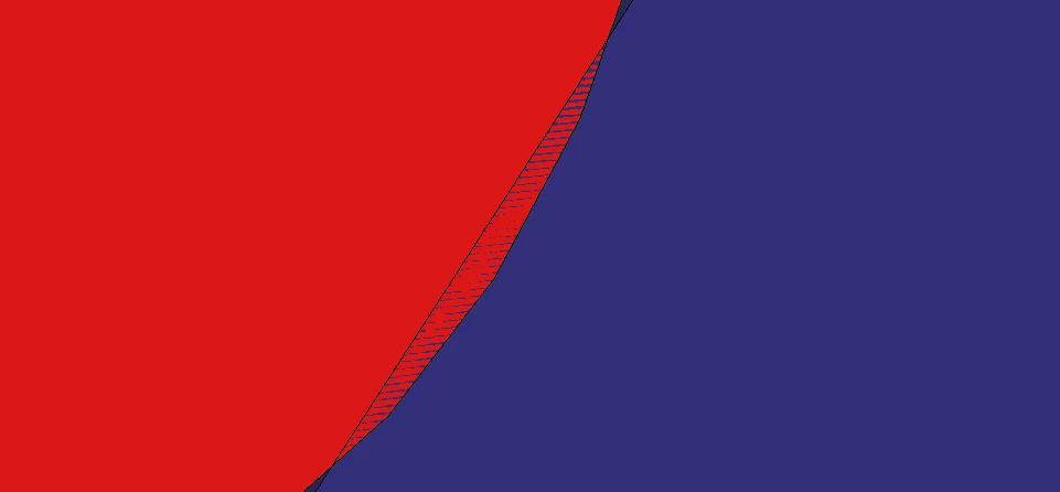

My problem is that as it can be seen the surfaces overlap when contact occurs instead of deforming it
I don't really know if i can share the model but if any other questions pls tell me
