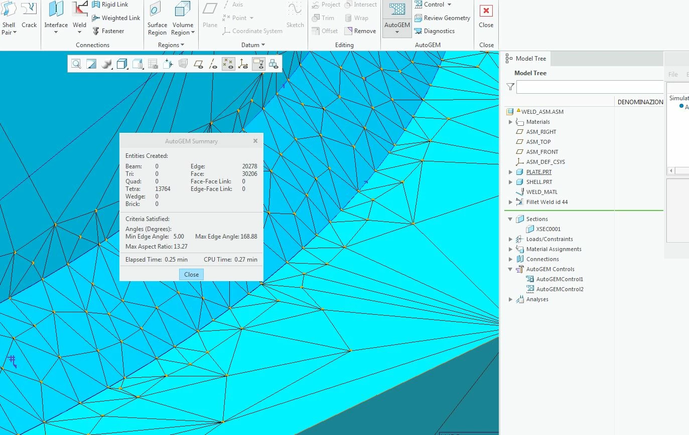

Hello Creo Simulate Community!
I am running a static structural analysis on a block placed into a slot and welded. My area of interest is the weld. I am using a weld feature from the Welding Application. When I look at the results, there are singularities near the weld (reentrant corners). When I try to isolate the edges of the slot for exclusion, all the elements that make up the weld are also excluded. I have tried using the mesh control for a component, but weld features not considered to be a component. Is there a way to control the welds mesh size that I am maybe missing?
Thank you all for your consideration on this question.

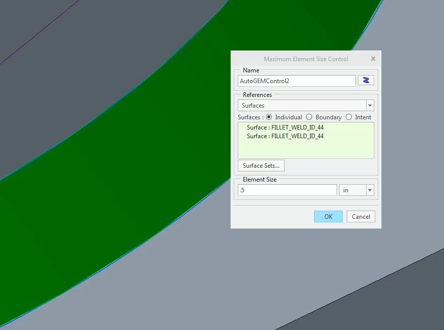

January 21, 2020
Hi you could try to use Mapped Mesh tool but, in my opinion, it's more easy (and at the end the result is more or less the same) usa a right maximum elements size control.
The right value you can find it only through iterative procsess...
