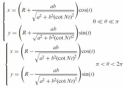

I want to use an equation with cotangent in the cylinder coordinate system.
Since cot is not a standard function, I use 1/tan, but I get an error message. Can somebody help me?

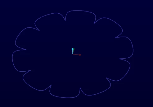

I'm trying to get to it in reverse, but having all kinds of errors 🙂
The closest I got was with the (t+.1) in the two ctan functions.
r=(7+(7*2)/sqrt(7^2+2^2*(cos(5*(t+.1)*360)/sin(5*(t+.1)*360))^2))
theta = 360*t
z = 0

I want to create two curves with these formulas in the cylinder coordinate system:
Many programs, e.g. Excel, can process 1/tan. In Creo I tried the following equations: (Both with error message)
r=(7+(7*2)/sqrt(7^2+2^2*(1/tan(5*t*360))^2))
r=(7+(7*2)/sqrt(7^2+2^2*(cos(5*t*360)/sin(5*t*360))^2))
theta = 360*t
z = 0
How could I solve this?
April 29, 2018
You have a division by zero error on the right side (your atan attempt).
If you replace t with (t+.1) it works but that's not the equation.
This tells me you want to process "t" before you fit it to the equation.
You can do this with an "if" statement bypassing the 0-state of "t"
If
t=0
then
myctan=0
else
myctan=cos(5*t*360)/sin(5*t*360)
endif
Use the variable "myctan" in place of the cotangent conversion
^ syntax not confirmed!
