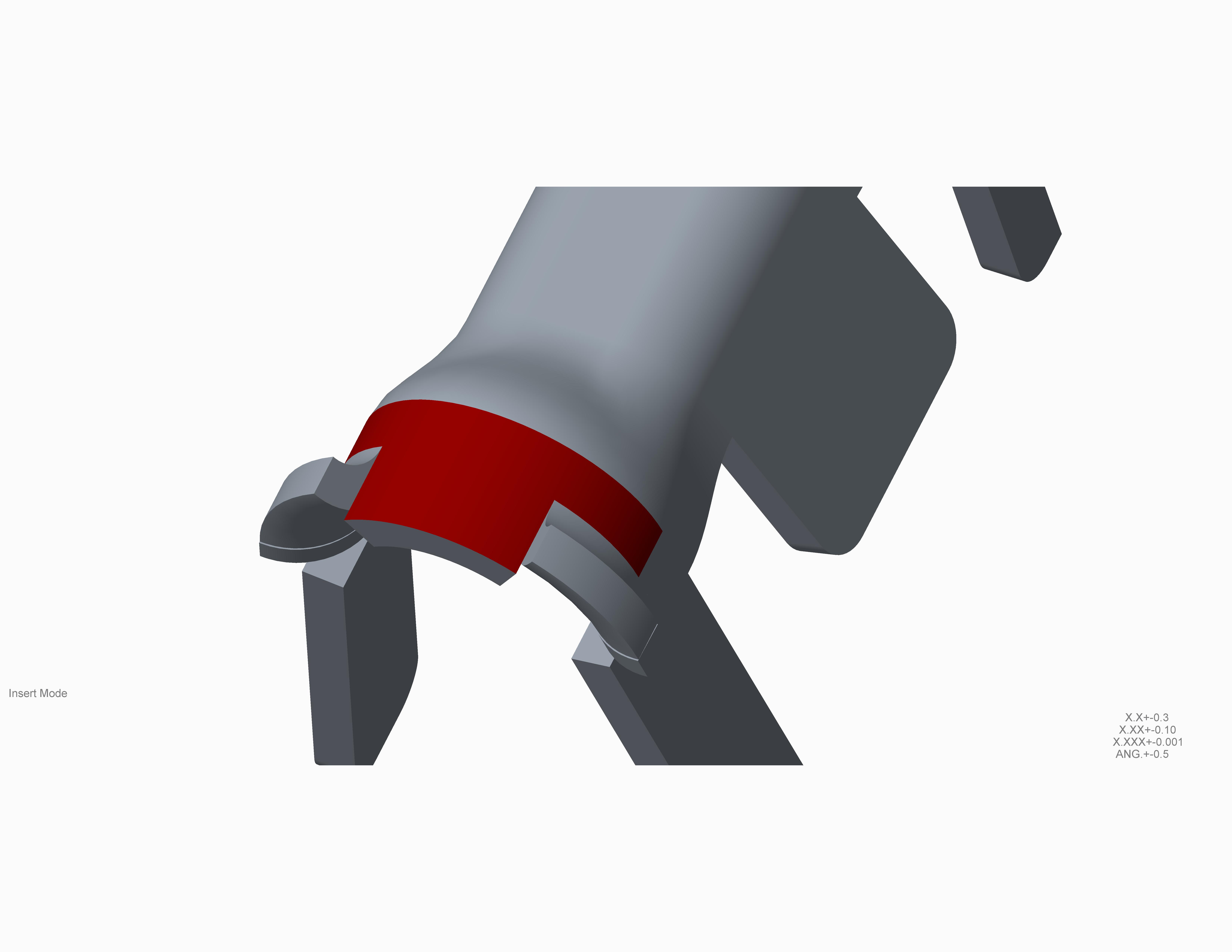

Making assuptions, did you try unselecting the Remove material normal to surface option? Text that doesn't go thru the sheetmetal feature will have a problem bending if that is selected (first icon in following pic).
