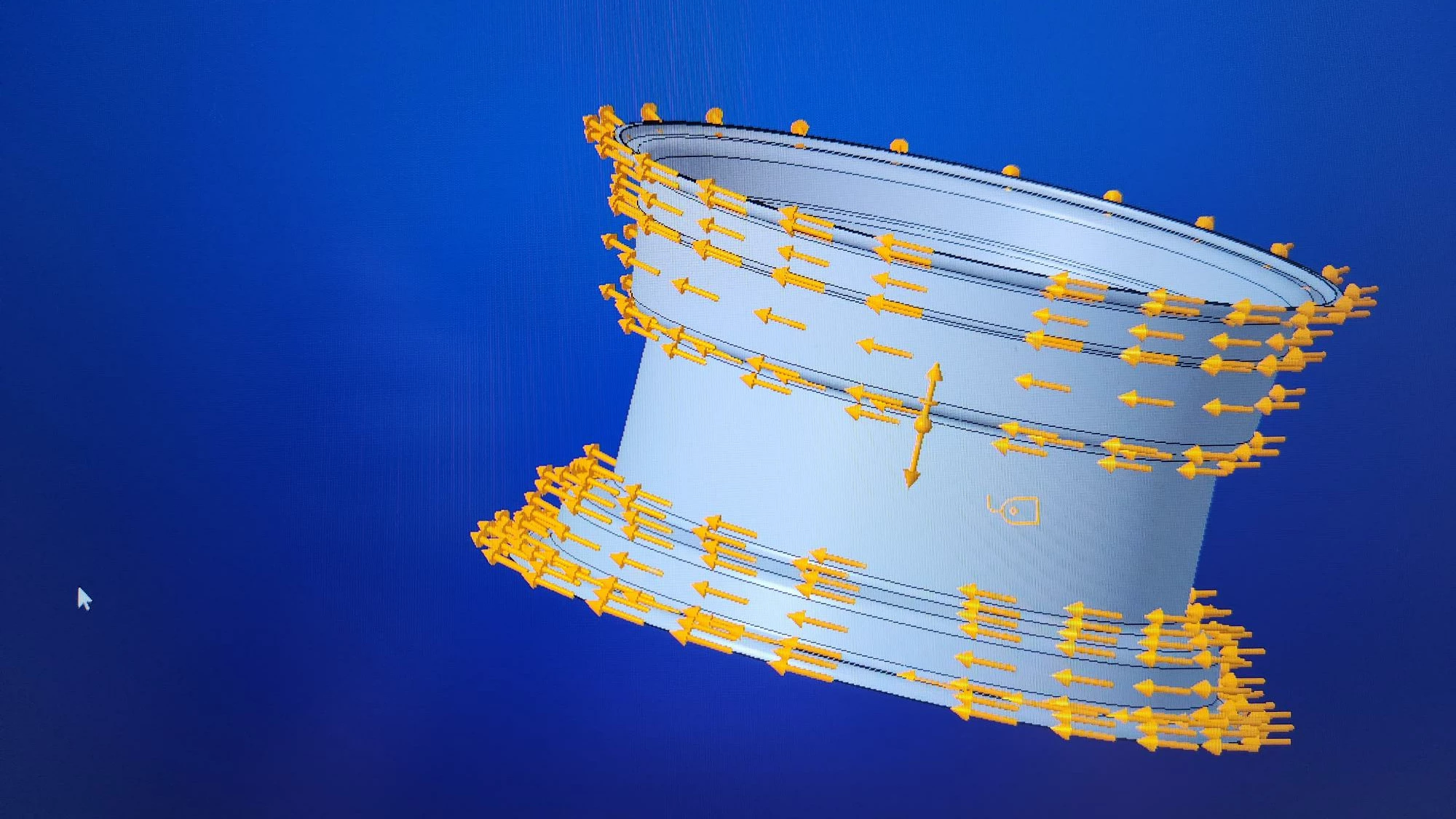

hello,

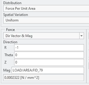

i would like to ask about the creation of the force on a round surface. L'ets say we have a cylinder  and a radial force is applied, ususally the force is perpondicular to the axe of the cyliner, but on creo simulate  this was not the case , visually the force was not perpondicular

You might be able to keep the load in N but should you?

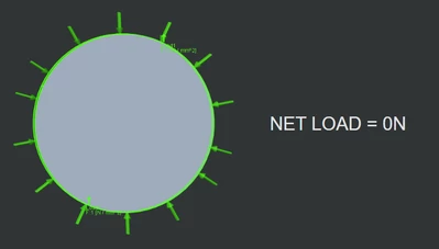

It really should be a  pressure because for a full circle load on a revolved shape Net Load is always 0N no matter what the magnitude of the pressure. (because every load has an opposite that cancels it)
Also, if you cant actually measure it with for example an Instron tester, you are never able to correlate results. Think about how are you actually applying this load in real life. For example if you split the model into 4 surfaces you could then apply a force to each quadrant with 4 separate rams and the force would be along the ram axis and 4 force transducers could be used and the Simulation could be made to match the setup. You would need to learn how to split surfaces to do this 4 surface variant. If you want to split it into more and more divisions some type of pattern feature might help. This seems rather tedious to me. Academically, the test setup is not really discussed but for analysist in industry we try to think of how the actual test looks and is applied.
Here are a similar examples that come up in a google image search..
It should be simple enough to measure the Area of the surface you are applying the load to and put Force/Area = Pressure.
If you are doing design variants that vary the area, there are a few more steps to get the pressure to automatically adapt to the changes in Area.

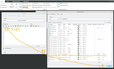

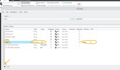

Create a parameter for the load to apply in N.

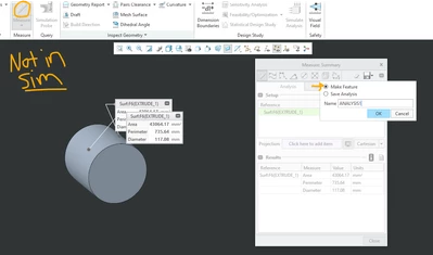

Not in simulate, create an analysis feature that measures the area.

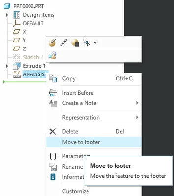

Its a good Idea to move the area analysis to the footer so it is always calculated last (unless you have a reason for a specific point in the tree)
FInd the parameter name for the measure of the area using the relations dialog.
(we don't need a relation we just need to get the naming)
Finally stick your formula F/A right in the loads pressure magnitude

Please share your model or simplified representation of it (or at least images) showing the issue you describe. Otherwise, I can imagine a few things that might help, each different dependent on the details.
Cheers
Sep 7, 2023 12:13 PM UTC
hello, thank you for replying
here is the picture
the force is supposed to be perpondicular to the ax of the cylinder
