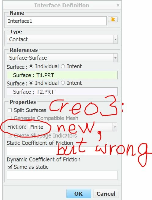

hi,
example 6: creo simulate 2.0 m080 vs. creo simulate 3.0 m130
without multithreading 10-20% analysis -> more time
regards
paul
PS: more examples?

October 18, 2017
example001
skunks
October 18, 2017
example002
skunks
October 18, 2017
example003
skunks
October 18, 2017
example004
skunks
October 18, 2017
example005

hi,
regards
paul
PS: more examples?
