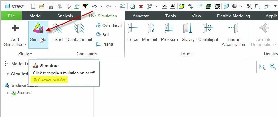

In Creo 6.0.4.0 I can run Live Simulation without any problems but in Creo 7.0.2.0 I can only assign constraints and loads as the Simulate 'button' is locked. Without adding floating license the constraint and loads icons including Simulate icons are greyed out.
Anyone experienced this issue.
Best answer by oull
SPR 12671141 has been corrected in Creo 7.0.4.0

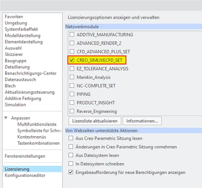

we made a test using a  floating License
and we can reproduce CSL Locked Simulate icon in case if the floating license option « CREO_SIMLIVECFD_SET » was not moved to right side  „startup extentions“:
After reconfiguring and then moving the floating license option « CREO_SIMLIVECFD_SET » to right side tot he „startup extentions“ , then the Simulate icon is displayed without Locked symbol !
However, this is not how the license should work.  It should be able to be used as a floating option.

I think that your company bought license extension (because it is cheaper than floating license). Check the contents of license file.

Hi Martin,
it is just a test "Trail" license for one month!
#PROBUNDLE_10138 1 Creo Simulation Live Plus Creo 7.0 Flt Opt
Expiration Date = 31-mar-2021
