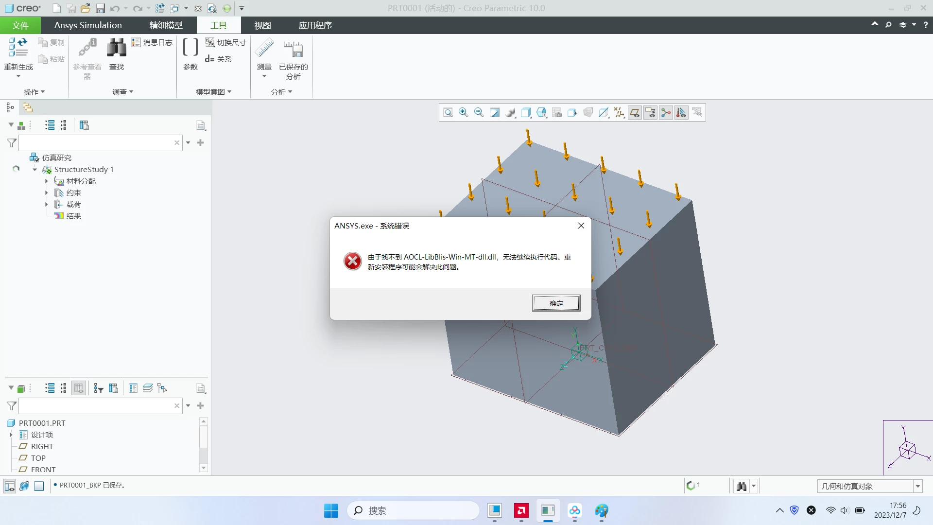

Creo Ansys Simulation does not run
  • December 7, 2023
  • 3 replies
  • 2135 views
Creo Ansys Simulation 不运行
December 7, 2023
I met the same problem in Creo 9.0 and Creo 10.0. In Creo 8.0 and Creo 7.0 analysis runs well.
I am almost sure that your computer contains AMD CPU. Is it true ?
If you have Commercial license then report the problem to PTC Support.
dreamless4-ParticipantAuthor
December 7, 2023
AMD  CPU
December 7, 2023
if you have Commercial license then report the problem to PTC Support.
