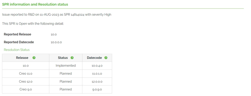

8-Gravel
May 8, 2024 7:10 AM UTC
they are still working on it, please wait until the next datecode 11.0.1, or you can use 10.0.4.
2024-05-08_140233.pnghttps://www.ptc.com/en/support/article/CS398825
May 8, 2024 7:32 AM UTC
OP can only keep his fingers crossed...
The main problem is that PTC ignores computers with AMD processor. Their support does not have such computers available!
Jun 5, 2024 9:08 AM UTC
Hello All,
According Article - CS417403 Creo 11.0.1.0 will already have a solution.
