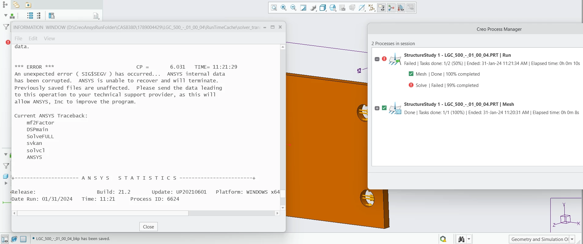

Hello everyone,
I have problem in Creo Ansys Simulation, every time I run the simulation with default setting always show message "Solve I Failed I 99% completed." even if running with simple part, and then stop not showing the result. Please help me, why this is happened?.
This specs my hardware
HP 255 g8 Notebook, 16 GB Memory Ram, AMD Ryzen 5 5500u 2.10 GHz With Radeon Graphics
OS Windows 11
Creo Version 9.0.6 & 10.0.3
The Error Messages
*** ERROR *** CP = 6.031 TIME= 11:21:29
An unexpected error ( SIG$SEGV ) has occurred... ANSYS internal data
has been corrupted. ANSYS is unable to recover and will terminate.
Previously saved files are unaffected. Please send the data leading
to this operation to your technical support provider, as this will
allow ANSYS, Inc to improve the program.

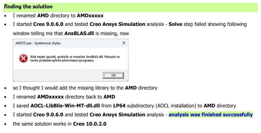

it is known problem related to AMD processor. See https://community.ptc.com/t5/Analysis/Creo-Ansys-Simulation-does-not-run/m-p/917113#M11788 discussion.
Try my solution mentioned in uploaded 02_problem_solving.pdf document.

Hi, it didn't works my friend and I don't know why,
I have tried copy file AOCL-LibBlis-Win-MT-dll.dll to AMD folder in Creo ansys installation directory and still get (Solve - Failed - 99% completed).

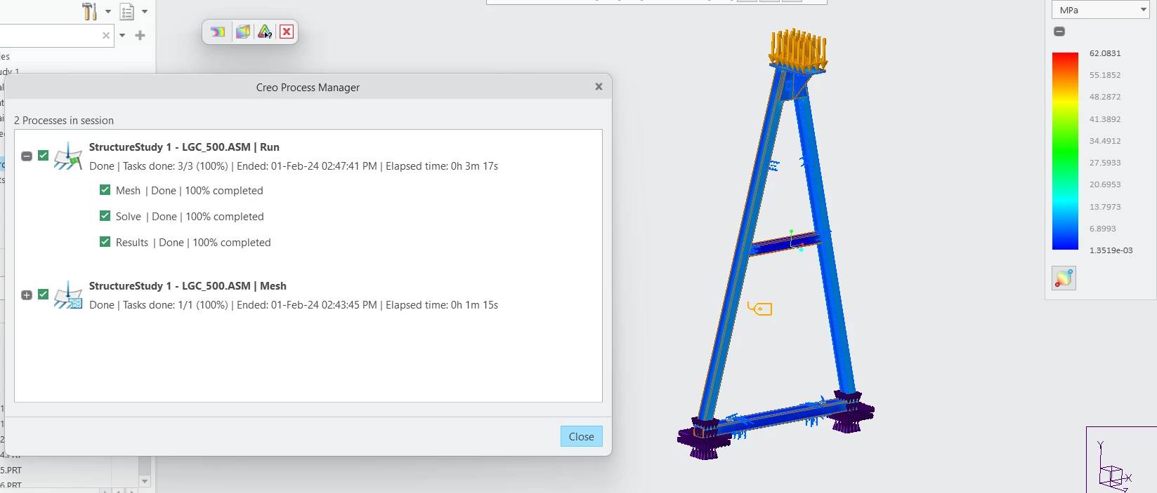

Now I installed Creo 8.0.5, and working fine without any problem
  • Creo 8.0.5 works fine because it contains older version of Creo Ansys Simulation (this version does not use AOCL-LibBlis-Win-MT-dll.dll library)
  • Creo 9.0.6 ... just check whether you copied AOCL-LibBlis-Win-MT-dll.dll library from LP64 subdirectory
  • I read your HW spec once again
    • it looks like your notebook does not contain dedicated graphic card ... it contains Radeon Graphics integrated on motherboard, only
    • my solution works on desktop computers equiped with dedicated graphic card NVIDIA RTX A4000
    • you can try installing latest drivers for Radeon Graphics
  • INFO:  https://www.ptc.com/en/support/article/CS404491
