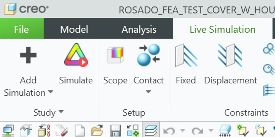

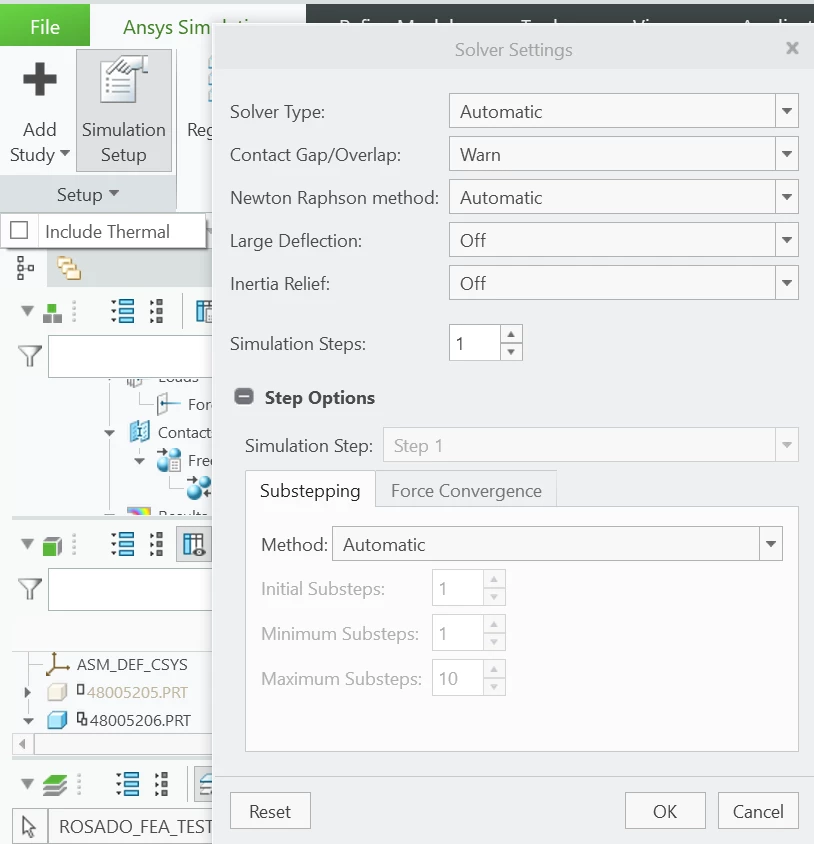

I am running Creo 10. I have both Creo Live Simulation (powered by Ansys) and Creo Ansys Simulation. I noticed that under setup in Creo Live simulation, I am able to select "Scope". However, when I look for this option in Creo Ansys Simulation, I don't see it.
It'd be convenient to be able to exclude unnecessary components, but still be able to run a more robust Ansys simulation. Is this option available somewhere that I'm not noticing?

Ah okay, so just to clarify, the "Scope" option is not available in Creo Ansys, correct? So I need to create an entirely separate assemblies omitting the parts I don't want simulated, right?
I mean, technically, I suppose I could suppress some components temporarily for the run, but the run will become out-of-date once I un-suppress those. And the next time I want to run the simulation, I will need to keep track of which ones I originally suppressed to get the results in the first place. So creating a separate assembly seems like a more reliable approach.
