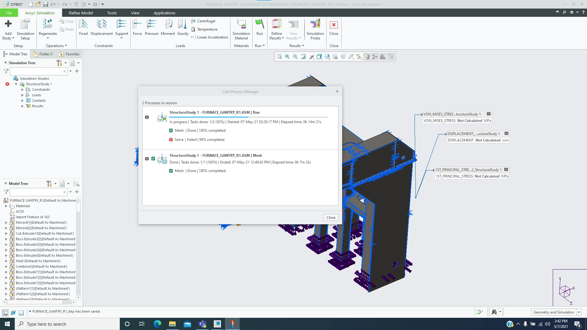

Creo Ansys Simulations fails to complete an analysis
I am using Creo Parametric 8.0 8.0.0.0
Analysis fails after mesh is created and 99% of the FEA is completed of a fairly complex assembly. The same assembly has been successfully analysed in Creo Simulate.

    NiloyGuha7-BedrockAuthor
    7-Bedrock
    May 7, 2021 9:24 AM UTC
    The error message is attached.

    Opened C15883128
    May 12, 2021 12:20 PM UTC
    For solution refer to article: https://www.ptc.com/appserver/cs/view/solution.jsp?n=CS344735
    Apr 23, 2023 9:16 AM UTC
    I got it also in Creo 9.0.4.0

    That could be some other problem as the specific problem that I had faced in Creo 8 was finally resolved in Creo 9.0.1.0.
