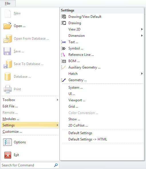

I am having difficulty with having Creo Elements Direct 18.1 reading my AM_CUSTOMIZE file. I am getting the same response no matter what I try.
LISP error: The function AM..... (no matter what function I am trying to load) is undefined.
What am I missing? Is it syntax in the file? Do I need to define something ahead of time?
I am new to Creo and this file is a copy of the one that has been used for years. It works in 15.50 but we are upgrading to 18.1 so I am guessing there has been changes, but I need help "upgrading" this file.
Please help
Thanks in Advance,
Mike
July 2, 2014
You should now set these preferences in the default settings interface.1.jpg

But wouldn't I have to do that at each individual machine? I would like to serve out these settings to all users and be able to make 1 change and have them all see it. Similar to how we do it with our Parametric install.
I have read through the customization help documentation and it is possible, but I must be missing something. I just don't know what.
Mike
July 2, 2014
I have all our "global" settings located on a network share that is read only to users. Each user has a personal network share location where any of their personal settings are located.
A batch file is used to start Elements/Direct and pointers are set to load these settings. With this setup you only make a change in one place and all users are updated.
Batch file looks similar to this.
set SDSITECUSTOMIZEDIR="global location"
set SDUSERCUSTOMIZEDIR="user location"
"C:\Program Files\PTC\Creo Elements\Direct Modeling 18.1\SD.exe" -e SDLANG=english "C:\Program Files\PTC\Creo Elements\Direct Modeling 18.1\binx64\SolidDesigner.exe"
