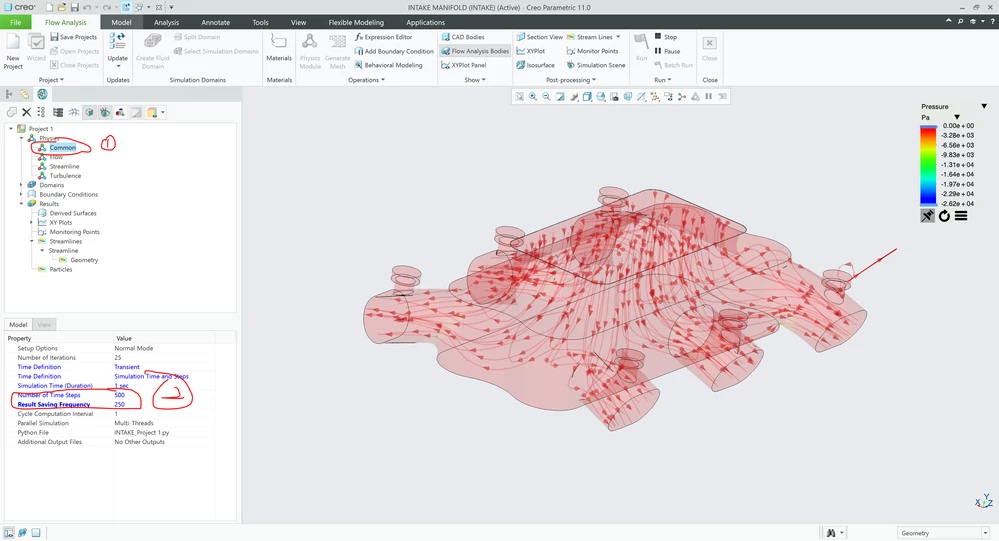

e.g. you setup is 500 steps for 1 sec, you can change saving to 250, you got 2 sres files one is for 0.5 sec, and the other is 1.0 sec. You can load it back and do post processing at that time step.
Nov 28, 2023 9:34 PM UTC
Hi Dominik,
You need to control the result saving frequency in the common model. After you simulate 1 sec, 0.5 sec result can be loaded back to do any post processing tasks.
