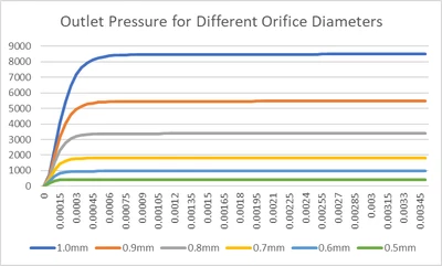

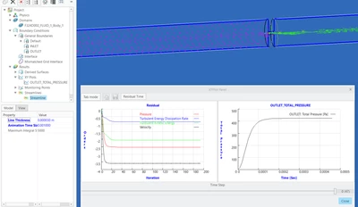

As a starting point, I have created a transient flow analysis of a simple brake line with a restriction, but without the piston element: the brake line is set with 8000000Pa inlet pressure and 0Pa outlet pressure but this is not yielding the expected results (i.e. a ramp up in pressure from zero, finishing with the outlet pressure equaling the  inlet pressure).
This is the result I obtain currently:
Looks o.k. so far, however if I simulate a number of different restriction diameters, I get this:
I would expect final outlet pressure to equal input pressure once the system reaches equilibrium if I have modelled it correctly - the results make me think my chosen model settings are wrong somewhere.

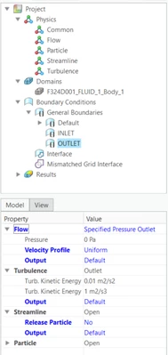

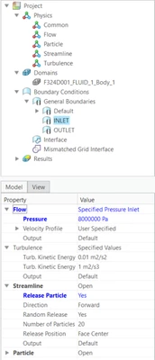

Inlet and Outlet settings are:
Inlet:
Outlet:

Thank you @cfdgeek - I think part of my issue was that my license would not allow creation of a moving/sliding mesh. I was trying to come up with a workaround without the need for the moving piston element by specifying appropriate boundary conditions for each end of the tube.
Aug 27, 2024 9:36 PM UTC
Got it. In this case, we can use expression to apply a transient boundary condition based on time steps.
