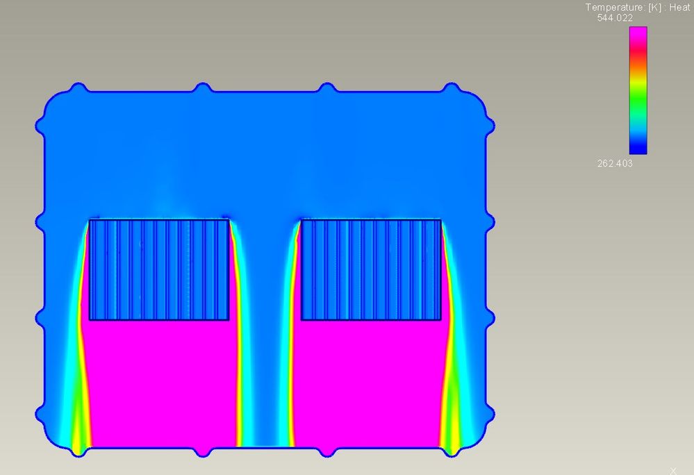

I'm sure this will be a simple Q. However, I'm unable to determine how to set my simulation to apply a thermal conductivity through the model?

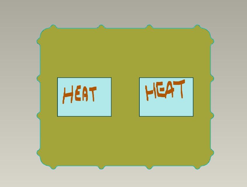

I've got two heat sources on the top surface of the model, 600W source each.
Heat-Source
I'm passing a flow of air of a series of fan blades & thus want to determine the effectiveness of the fan blades.

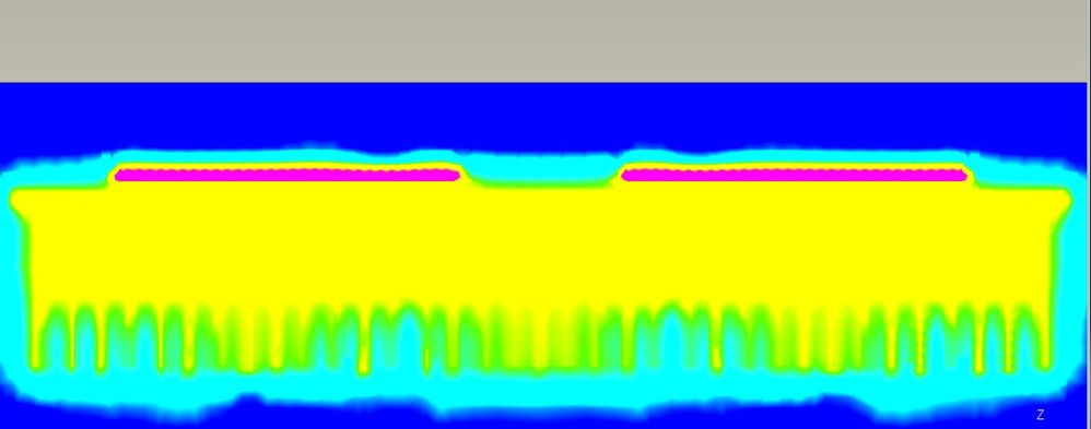

When I set the simulation up - I am able to determine the effect of the heat source on the surface of the model however I think that the heat isn't being transferred to the fins in a method I would expect. My results can be seen below.
Streamline HeatStreamline HeatTop down Model View Heating EffectTop down Model View Heating EffectFront On Heating Effect Temperature EffectFront On Heating Effect Temperature Effect

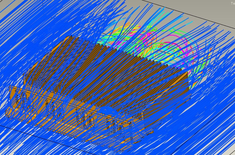

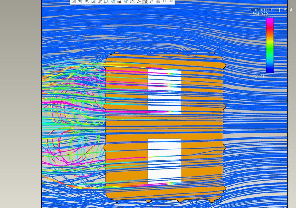

This all looked promising. However, when I section the model, I see that no heat has been transferred through the model. I can confirm this through the streamline heat, see images below. Streamline UndersideStreamline UndersideHeat X-SectionHeat X-Section

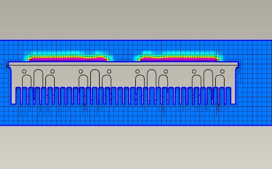

Edit 1: With a bit more searching I've managed to find a setting on the mesh function that meshes internal volumes. This has helped a touch; however, my next issue is that I can't get any heat transfer through the Heat Dump into the part itself. See image below.
Temperature Step ChangeTemperature Step Change

Is this a single solid part or an assembly? In your top down view, it looks like there are two parts with fins attached to a base but it doesn't look like that in the other views.
If it's an assembly:
Make sure you have material and thermal properties assigned to all of the parts
After generating the mesh there would be interfaces between the solid parts. Make sure these are conjugate walls. These might be where you would assign the heat source. There should also be interfaces between the solids and the air domain which should also be conjugate walls.

Hi, Thank you for your reply. In the model above i had model the IGBT as a separate body within the same model. When I changed the IGBT to seperate parts the model was working as intended. Thank you for your response.
