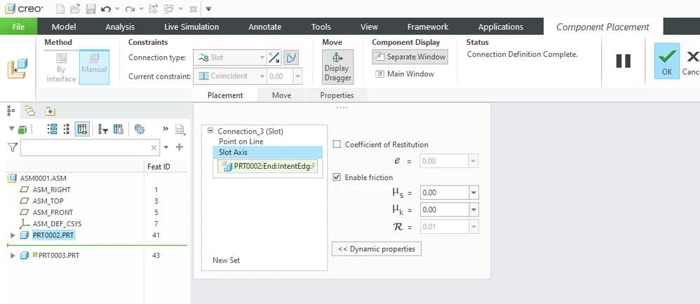

I'm trying to build a CREO Mechanism for lead screw, I'm using Slot connection to define the lead screw mechanism. Now I'm running a dynamic analysis by selecting friction in external loads options. but im unable to input the friction value. Does creo assume a value, or can  I input a value

Hi @VU_10973325
You can define the friction coefficients when defining the placement of the component in the assembly.  If already placed, Edit the Definition of that component.
Dynamic PropertiesDynamic PropertiesFriction coefficientsFriction coefficients

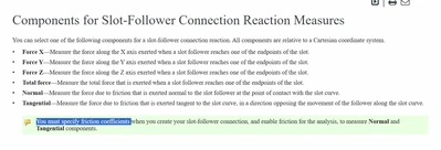

Did you try this article : https://www.ptc.com/en/support/article/CS335920 ?

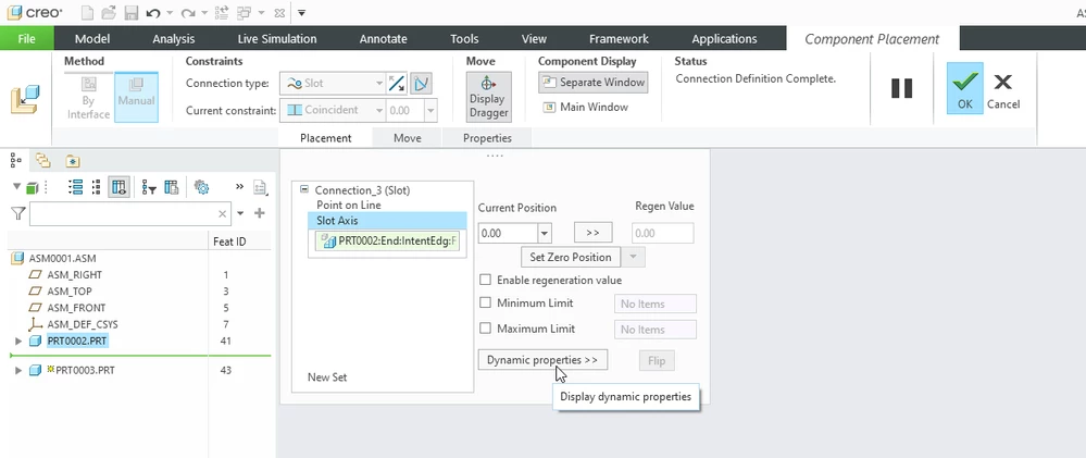

I'm working on Creo 9, I couldn't find any such option as Placement > Slot Axis > Dynamic Properties. Can you help me through navigate the process for inputing friction coefficient for slot connection. Do you thing I need to give any cam connect along with slot connection.

Here as stated where can I input friction for Slot-Follower

Hi @VU_10973325

Jun 26, 2025 9:56 AM UTC
Hi Mike , Can help me in understanding how to select slot axis, because the friction has to applied on the helical curve, as that where contact happens, but in slot axis pop out, I'm unable to select the curve.
