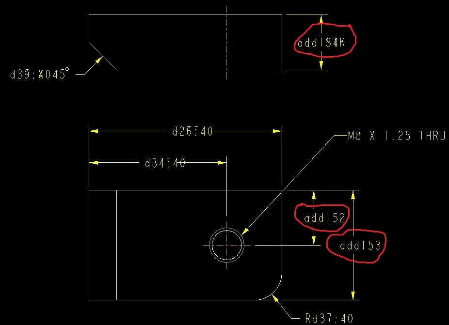

We migrated to Creo Elements/Pro 5.0 M140 on Monday and I've been experiencing an issue with dimensions not showing on drawings. I've tried every iteration of Show Model Annotations conceivable and they do not show up. They don't show up as Annotations under the view and aren't erased. I've had to resort to drawing created dimensions for them, see the attached jpg.
Has anyone else encountered this issue? This has happened on multiple drawings of different parts and assemblies.

Not sure if this is the solution because you mention they're not erased, but it's worth a try.
While in the Annotate tab, try going to the drawing tree and expanding the annotations node for the view in question. Pick through the dimensions you see there to check if the missing dims highlight. If so, you can right-click and pick "unerase".

I had already tried doing that and they don't show up in any other view as erased annotations. It's like they don't exist in the drawing, at all.

We had something like this happen where some dimensions seemed to be in limbo. They weren't showing on the drawing and they weren't in the list of annotations in the drawing tree and they weren't in the list in the show model annotations window. While in the drawing, go into layers. In the layer tree, go the layer (hopefully you have one) that lists the dimensions. Start clicking on the dimensions in the list and see if any of the missing dimensions highlight in the drawing. If they do, select them and delete them. Now when you go to the show model annotations window they should show up in the list to show on the drawing.

Well, I seem to be having the same problem here. This part has only three features in the model; one 'protrusion' (sq tube), one 'chamfer' (on each end of tube), and one 'extrude' (hole). I cannot get one of the holes dimensions to show. It's not erased, it's not on a layer, and I don't know where it is.
If I add another hole, no problem to get the dims to show whether it's an 'extrusion' or a 'hole'.
Where the h*** is that missing dim???
