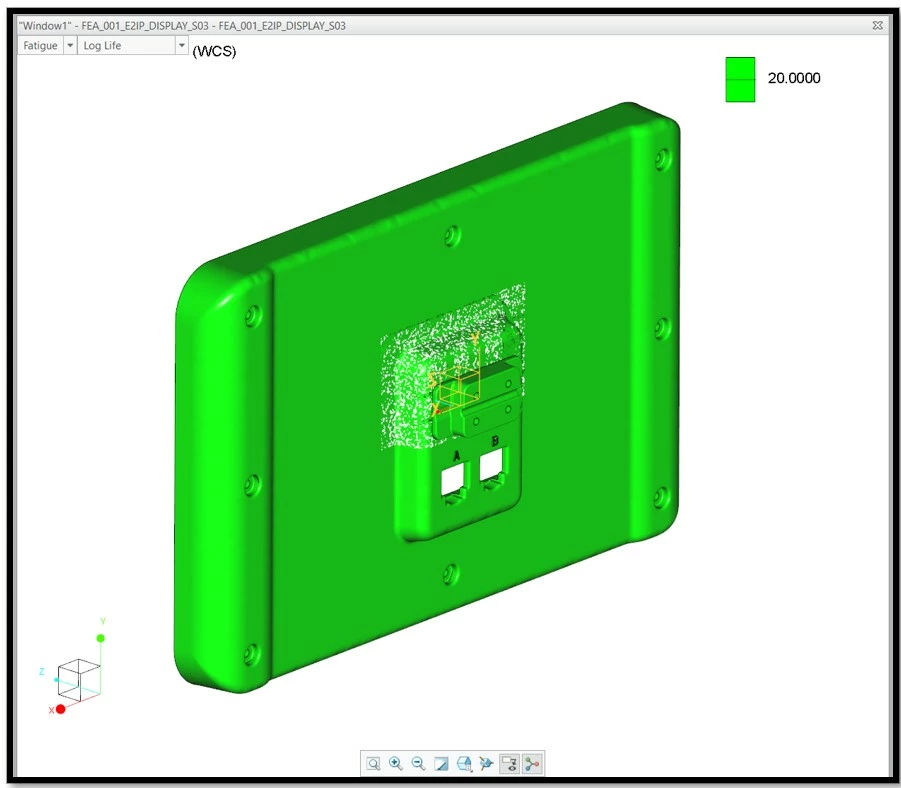

Looking at the Fatigue study results, can anyone offer any clarification on the Log Life values?  For this model Creo is giving me a Log Life of (20).
How does this calculate to the life of the component if the desired life in the study was set to 50K cycle

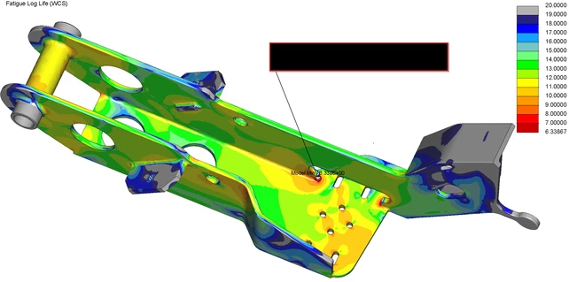

Take a look:
skunks
Aug 8, 2023 12:39 PM UTC
The picture should look different, see my example:
Number 6 corresponds to 1 million load cycles,
Number 7 corresponds to 10 million load cycles.

In other words, if the load cycles I input into the study setup was (50,000) and my Log Life result was (20) the the total number of cycles to failure is (50,000^20) cycles?
