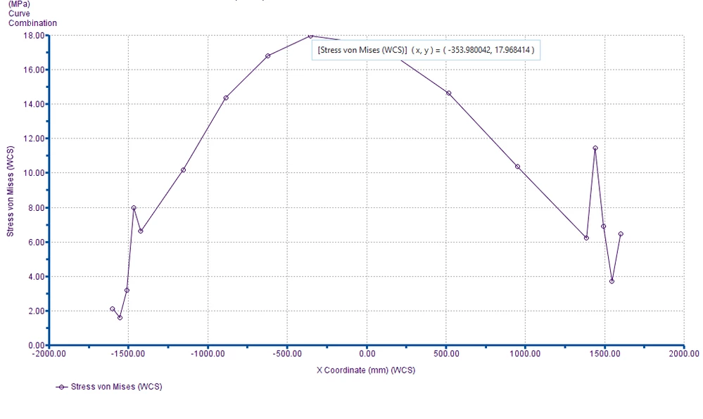

Hi, I get a graph result on one of the edges of a beam, it looks like this.
Since the point on the graph is kind of random, I'm curious how does the Creo Simulate picks the points that are shown to me? Is the maximum point I see in this graph has to be the maximum stress along the whole curve?
Thanks!
February 26, 2020
The points on the graph are calculated based on the type of mesh,  if you mesh using the mesh controls such as Mapped Mesh or Prismatic you can get the points displayed at uniform intervals as shown in the figure. Also the maximum point you see in the graph corresponds to the maximum stress of the point at that location on the edge but not for the whole cure.
