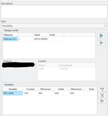

I am running a simulation with a measured load at one side, and applied load at another. For all intents and purposes, it is a non-symmetric see-saw, where I have a target load at one end, with a load (in this instance, a pressure value) applied to a pad at the other end.

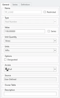

I will have 9 individual tests to complete (each test is at a different angle), so I was hoping to run a feasibility study to save myself the trial and error involved in guessing the input load multiple times until I get a close result. I have had a bit of a play around and created a parameter, which I then drove a load value with.
It seems to accept the input parameter (I can drive a static analysis from it) but when it comes to doing a study, I get the '!' of doom with no indication of the cause of failure. Screenshots of my parameter and study are below.
Is what i am trying actually possible and if so, is there something obvious I am missing?
