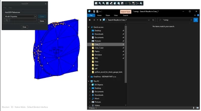

Creo Simulate Mesh files directory *.mmp and *.mma
Hello, I've been trying to find those files all around Windchill and my local PC but didn't succeed in that. Where does creo simulate save mesh files?

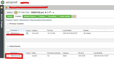

It took me a while to figure out where it's actually saved. However, it's not in the folder you showed.
I tried following the method you described, but nothing appears in that folder.
I did manage to find the file in Windchill, though. So it seems no separate local files are created on the PC — everything is always stored as part of the cache in Windchill.

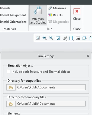

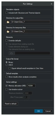

Hi @ilyachaban
If you have not changed the default settings, it is in a subfolder of your working directory. The name of the sub-folder matches the name of the analysis.
