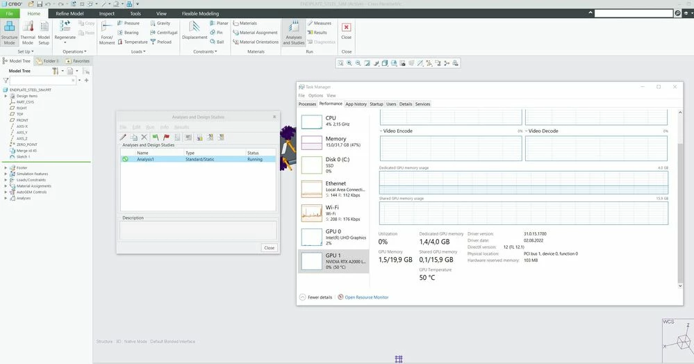

Creo Simulate not using system.
Hello Gentleman,
I am running Creo 8.0 structural simulation. It takes a lots of time to run the simulation, while system is barely working CPU roughly 4% and GPU around 0. When I`m moving the 3d part the gpu goes up, so the settings are correct in the nvidia panel.
GPU:
RTX A2000 Laptop
CPU:
11gen i7-11850 @2,5Ghz
RAM:
32GB
Can you please help how to improve the system usage of creo?

please read https://www.ptc.com/en/support/article/cs353528 article.

Thanks a lot for the answer, sadly my system is not loaded by the Creo even after doing the instruction in the linked article, but it made I think faster. I would be happy to see gpu/cpu usage way up, not like at 0% and 10%.
