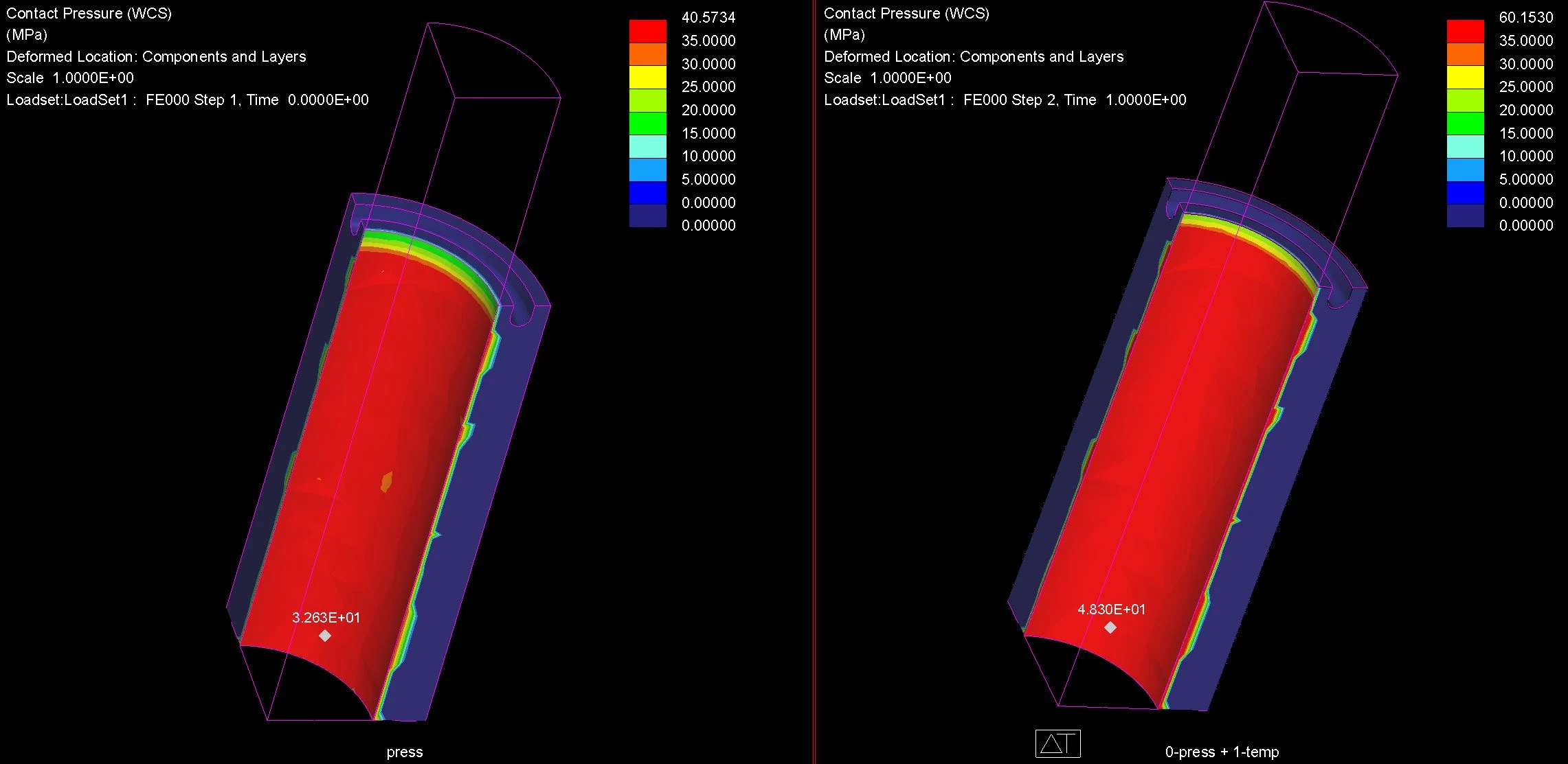

Let's say I wanted to see what happened to these contact stresses if the assembly was cooled to -40C after being pressed in at room temperature.  How would I run that?  TIA
