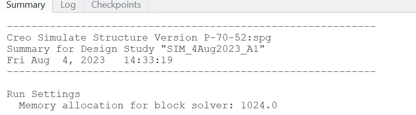

Creo Simulate - RAM allocation value is not reflecting in run summary

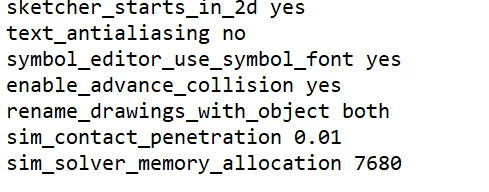

User is trying to allocate more RAM for his Creo Simulation by updating config.pro file, but it doesn't seem to be reflecting in run summary.
sim_solver_memory_allocation

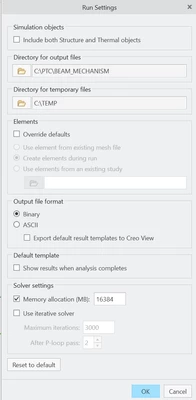

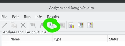

Always check this location shown in the image below. It takes precedence and is stored with the part file. Only new simulations will take the config file setting. (Max is currently 16384 MB by the way) [Also directory for output files and temp files are stored with the part file and may need to be reset if your new practice is different.]
If you run by batch file the command line option is like: -solram 16384
BTW Max RAM is not always optimal for speed.

Hi Sweerpeahub-old,
Thanks for the solution, this helped to resolve the issue.
