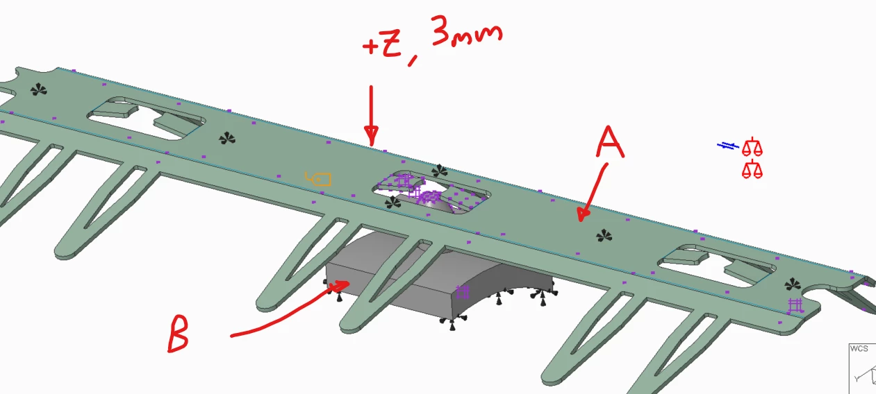

I am trying to simulate a press-fit snap feature for validation, however when I run the simulation I get the error “Run completed with fatal error”.
Following parameters are set:

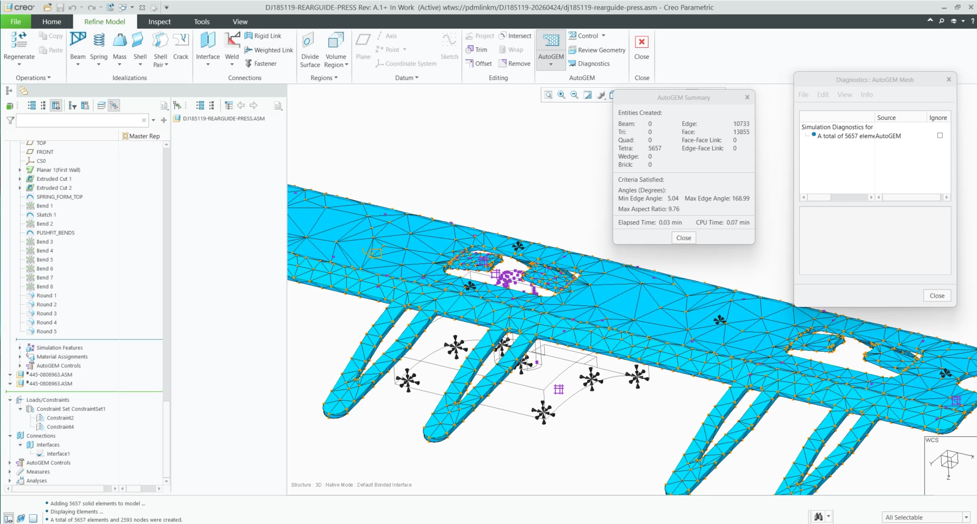

Mesh:
  • Component-component interface (contact), assumed 0 friction (also attempted surface-surface contact with 0.2 COF)
  • Mesh on both parts with 1mm localized elements on snap-features (tetrahedral)
Constraints:
  • Prescribed 3mm movement in +Z direction on Part A (to push part A onto part B), fixed in X and Y direction
  • Part B constrained in XYZ direction

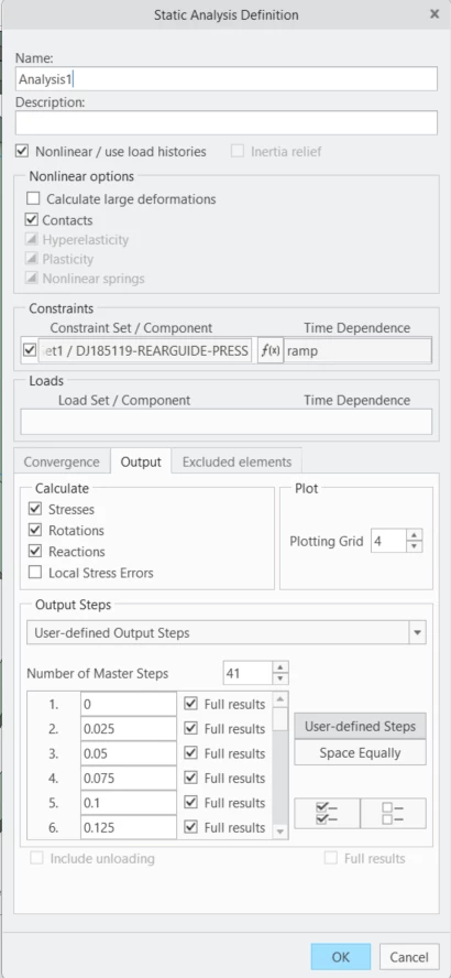

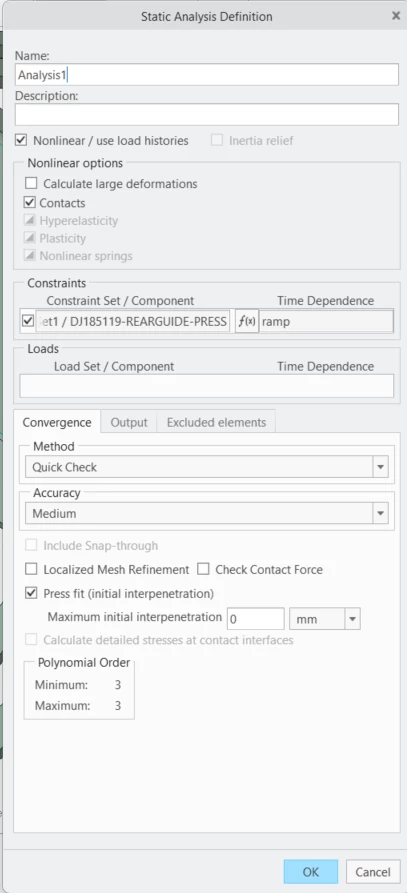

Analysis Settings:

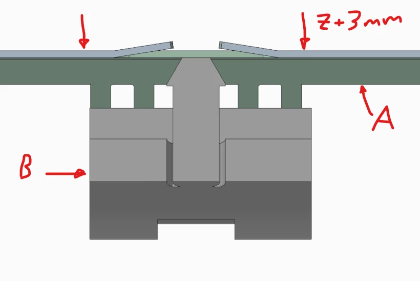

Section view of snap fit
