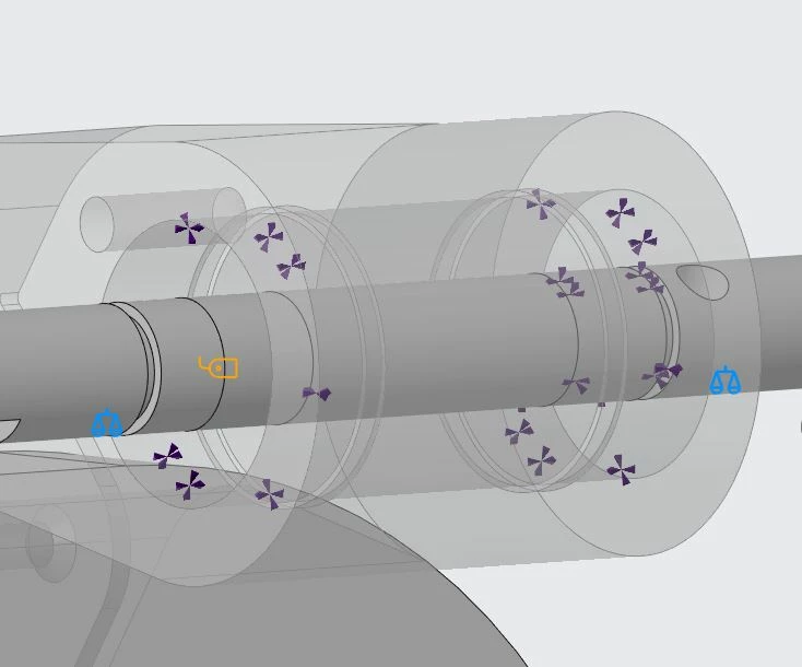

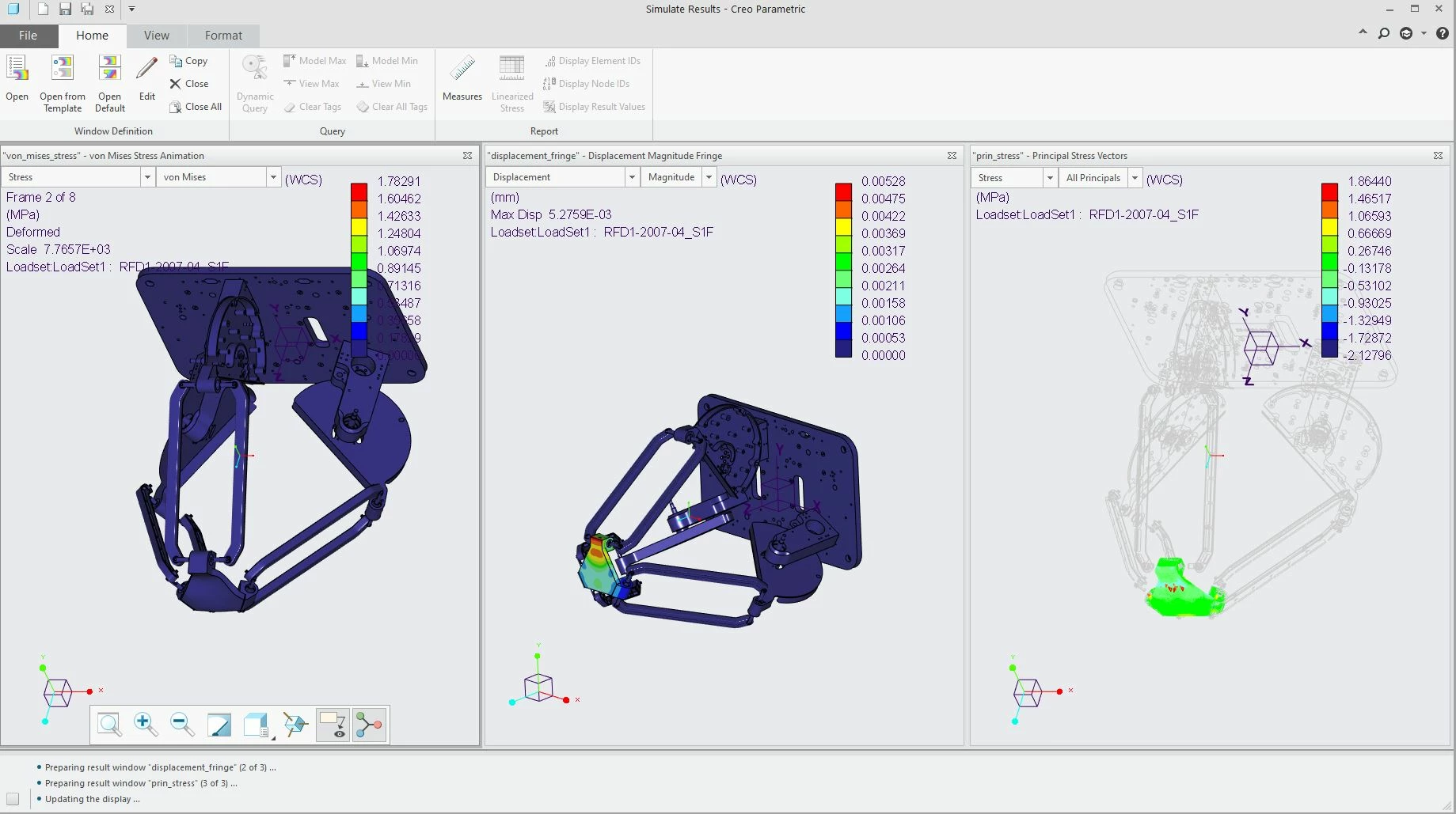

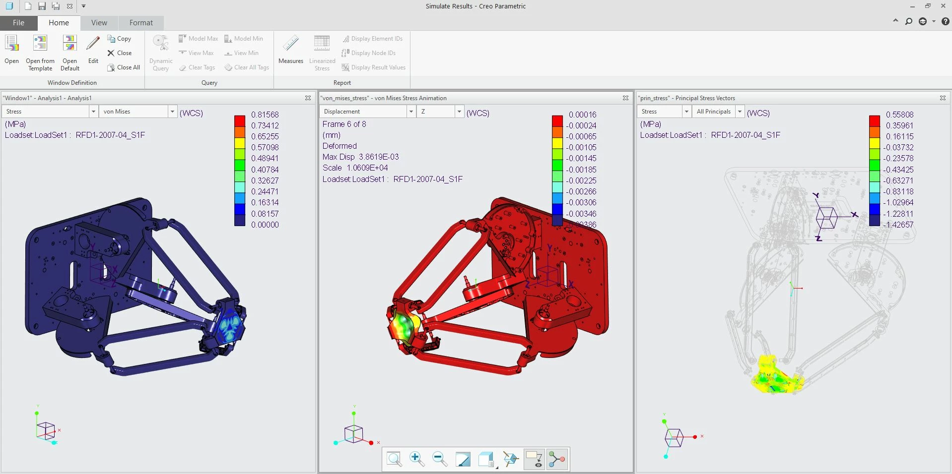

I am currently trying to apply a force on an assembly, a delta robot, more precisely on its end-effector. The problem is that the stress/force is not passing through the different parts. It is like if the static analysis is only considering the part I applied the force on.
I have simplified this first analysis by bounding some parts, the one that are screwed together.
I have also not included the bearings for all joints, the idea was to link the parts without the bearings. For that, I have used the "Function Pin" of the constraints. The first joints of the delta robot are blocked axially and radially, then, all other joints are just blocked axially.

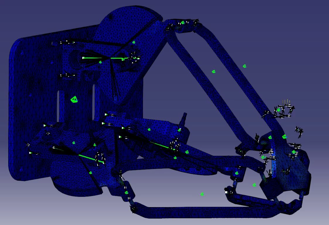

This method works on Catia V5.

creo-study1-1 and creo-study1-2 : show the result of this wrong analysis.
creo-study1-3 : shows the way I have constraint the joints, which have 2 bearings.
catia-study1-1 : this is the analysis on Catia V5

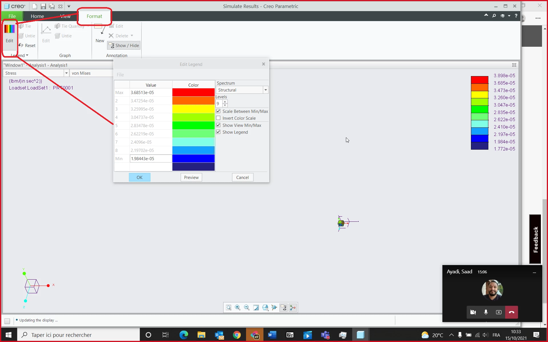

Hello All,
It seems that it is regarding a small load maybe you can edit the legend in Result windows by increasing the min value

I did try to modifiy the scale, but the behavior remain unchanged.

Oct 15, 2021 10:43 AM UTC
It appears to me that you are not setting up your constraints correctly. You should not have displacement constraints on the joints. If you need to release degrees of freedom at the joints I would suggest using beams to connect your joints and then releasing whatever degrees of freedom you want with the beam ends.

In the Beam definition, I cannot define all the surfaces that would interact through the bearing. How would you do it.
In Catia, I have never included the bearing, a connection was defined manually, and I was then specifying that this connection is a rigid virtual connection (with the rotation unlocked). Then, only the created parts were deforming.
