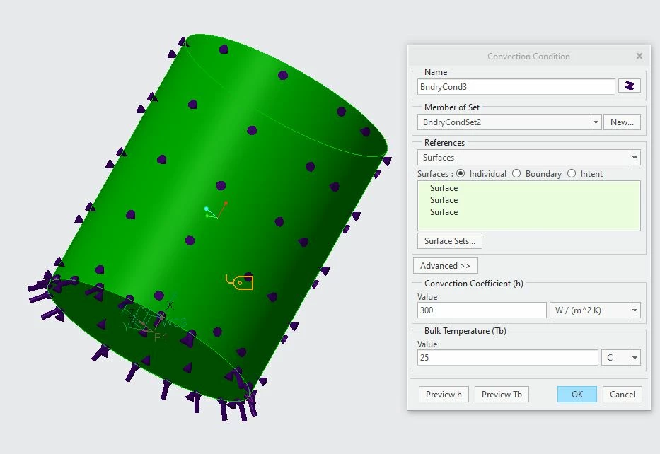

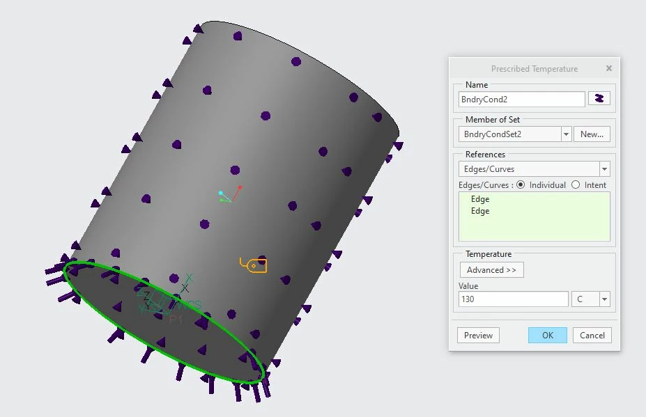

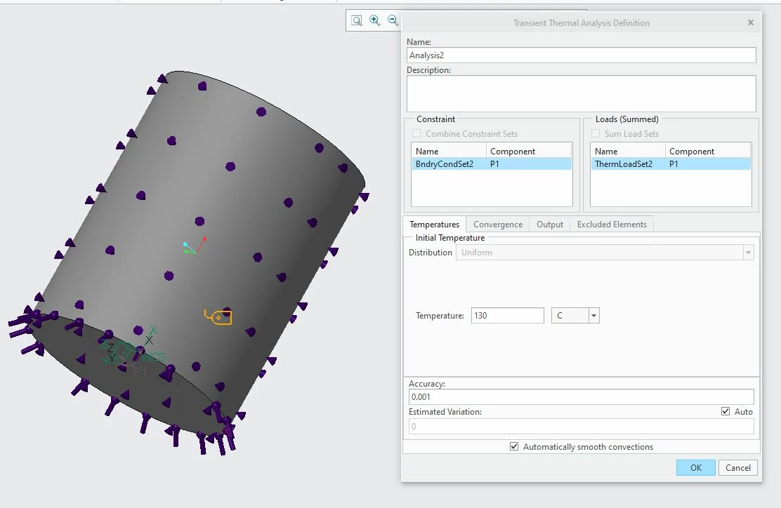

i have an aluminium cylinder De60 Di54 L148 [mm]
with the attached condition (Condition 1 e 2 . jpg)

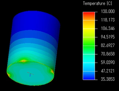

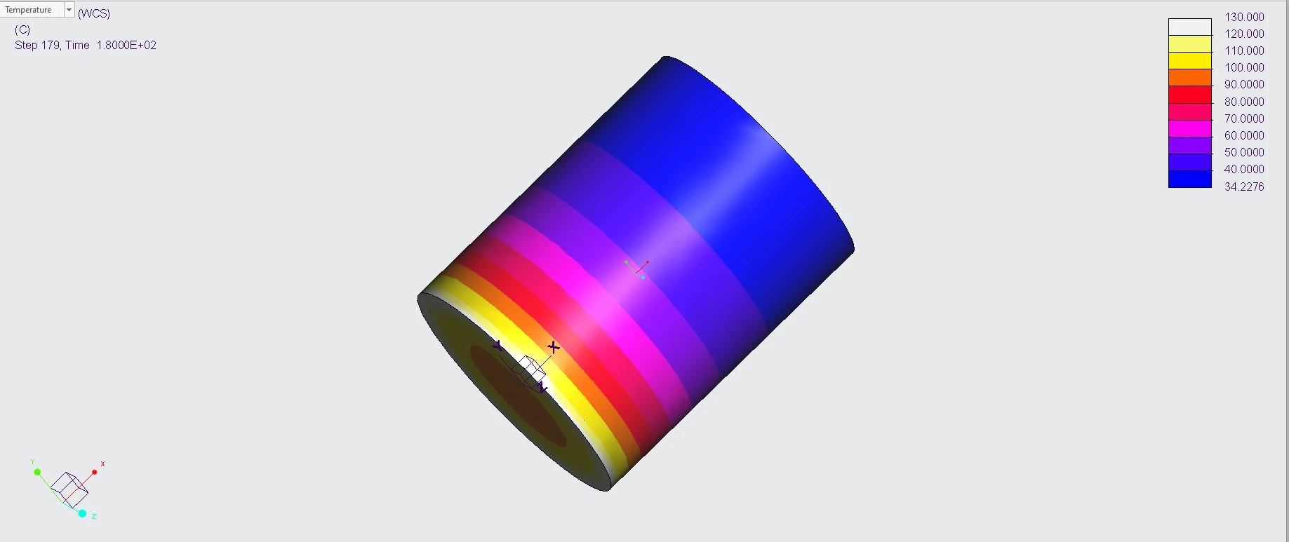

As a result of the thermal analysis (Thermal_analysis.jpg) i have what show in "Result.jpg" about thermal analysis
I'm not sure that is correct
Can you give me your opinion about it?
Thank you
Jul 1, 2025 6:14 PM UTC
Your model proportions do not look correct to Diameter 60mm X Length 148mm  with t=3mm.
Jul 2, 2025 6:13 AM UTC
Sorry Radius external 60 Radius internal 54 Length 148 mm
Jul 23, 2025 12:21 AM UTC
I've done similar analysis with another solver and got similar result.
